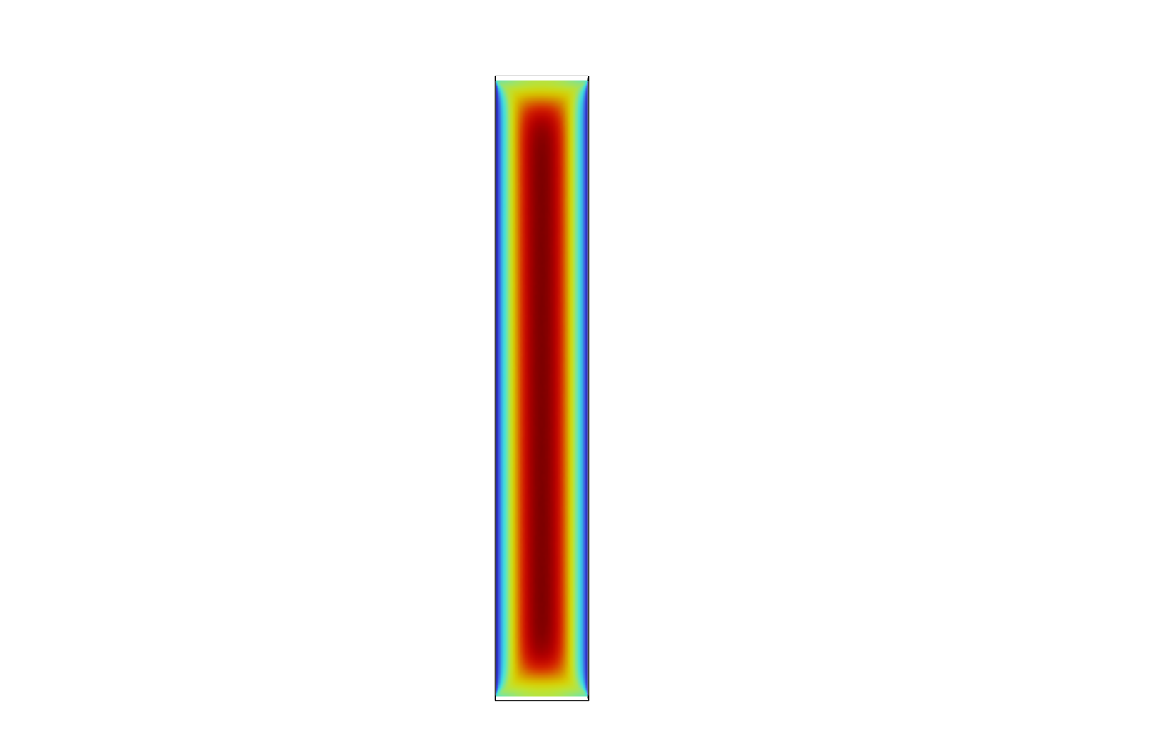

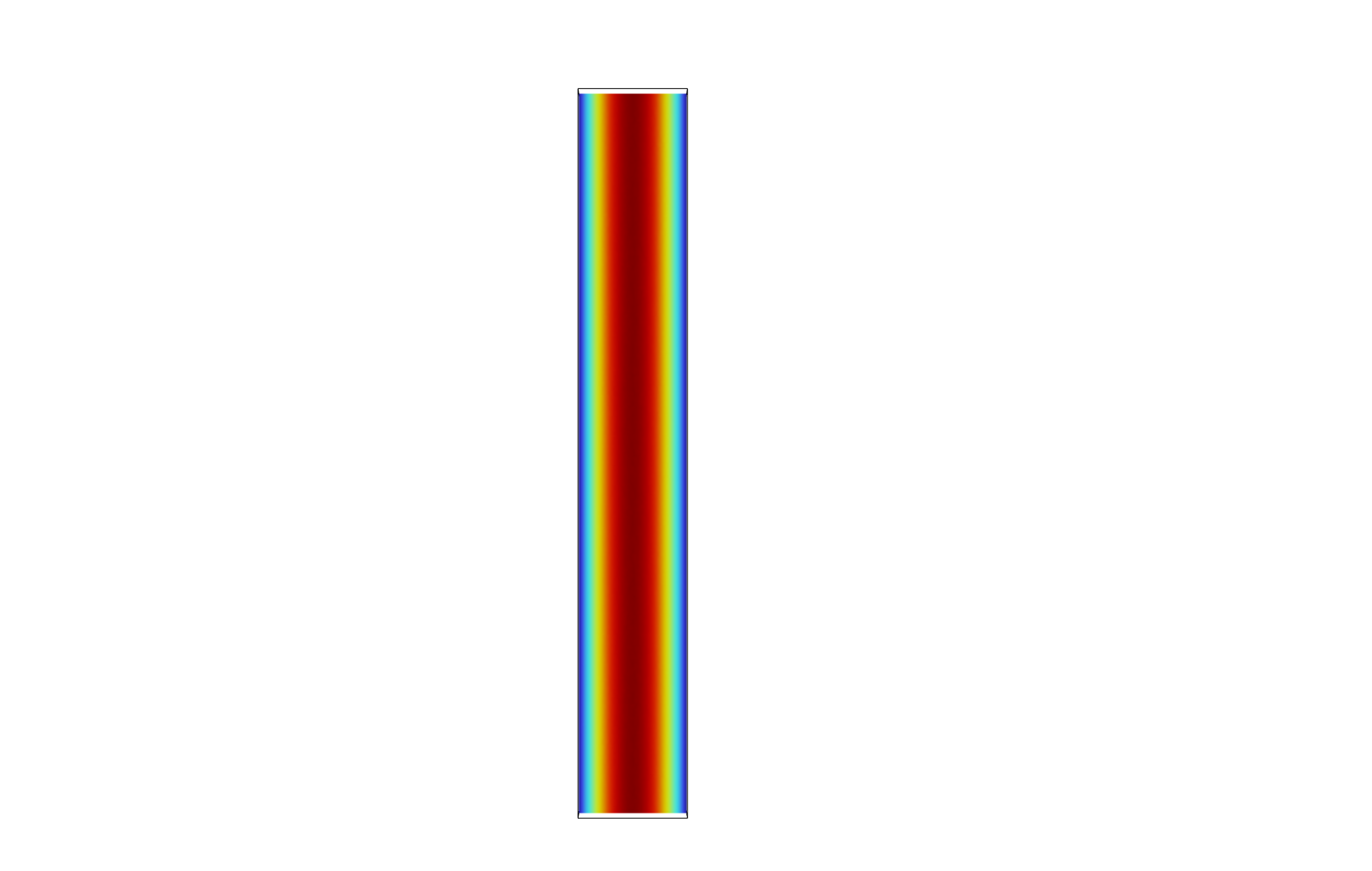

For laminar single phase flow through microchannel, When I put inlet and outlet condition: fully developed and wall as: No slip, I get fully developed profile from the very entrance of the channel. However when I Change the wall condition to Navier slip [20nm] while keeping both the inlet and outlet condition same, I dont get the fully developed profile from the very inlet.
Could anyone please explain the issue?
