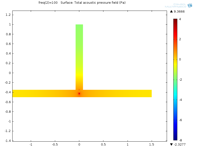

The first picture is 2D at a 100 Hz.

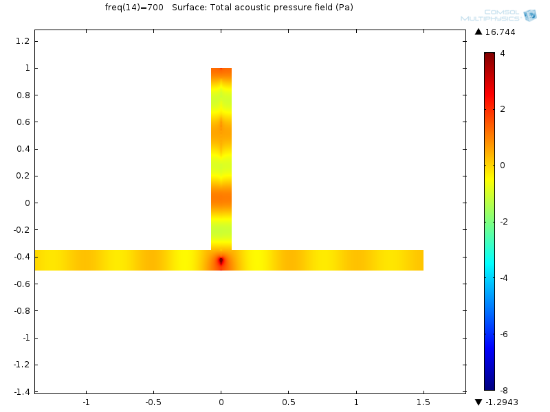

The second one 2D at 700 Hz.
As you can see there is a singularity kind of thing in the center of the junction and the pressure distribution looks kind of strange.

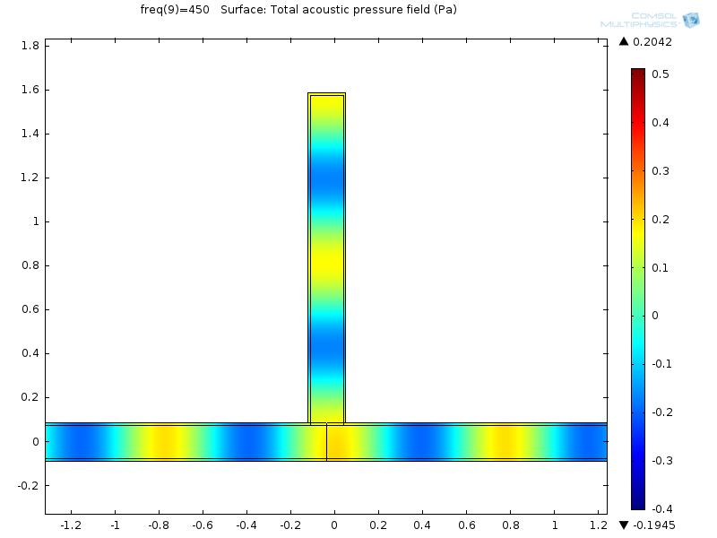

I attached my COMSOL file for the 2D duct and a picture of the 3D result. So far I have done most of the simulations with 3D , but if 2D would work it would save me a lot of time. Maybe I am doing something wrong with the B.C.s?

Hi Dan,
The problem with your 2D analysis is that it is 2D axisymmetric instead of 2D planar.

yes, that solved the problem, don't know why I did that.
