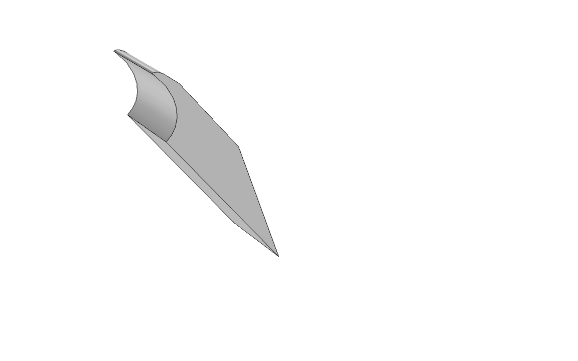

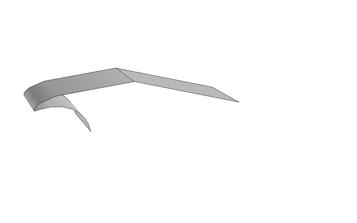

I am not 100% sure what you would like to generate. This is how I interpreted it:
1-) In a 3D geometry, right-click the Geometry 1 -node and add a workplane.
2-) Right-click Model 1>Geometry 1>Work Plane 1>Plane Geometry and add a Bézier-Polygon which can be piecewise linear, quadratic or cubic. (screenshot1.png). If you would like this curve to be closed (to be a surface), just change the type.
3-) Right-click Workplane 1 and choose Extrude -> You have a surface (solid, if you chose closed and solid in 2-)) in 3D.
If you are looking for topographical maps, please check model www.comsol.com/showroom/gallery/3807/
Hope that helps.
Winfried
