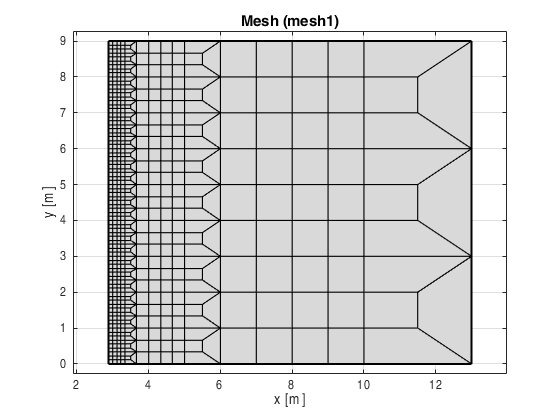

I don't think there is a way to create this mesh in Comsol without programming a bit.
The Programming Reference Manual has a section called "Setting or Modifying Mesh Data" that you need to study.
Using LiveLink for Matlab I've created part of the mesh to show one of the method that can be used to make the mesh. I'm not sure if the left side of the mesh is supposed to be created manually the way it looks or the mesh in intended to be created to form a rectangle and then deformed using solid mechanics so I've left that part as an exercise to the reader ;-) A derformed mesh can be exported to be used as a basis for futher modelling.
I've attached the Matlab script I used. As you can see it requires some work to create such a mesh, but it can be done.

I don't think there is a way to create this mesh in Comsol without programming a bit. The Programming Reference Manual has a section called "Setting or Modifying Mesh Data" that you need to study. Using LiveLink for Matlab I've created part of the mesh to show one of the method that can be used to make the mesh. I'm not sure if the left side of the mesh is supposed to be created manually the way it looks or the mesh in intended to be created to form a rectangle and then deformed using solid mechanics so I've left that part as an exercise to the reader ;-) A derformed mesh can be exported to be used as a basis for futher modelling. I've attached the Matlab script I used. As you can see it requires some work to create such a mesh, but it can be done.
Posted: 2 years ago 22.11.2023, 09:23 GMT-5
However, an important question is whether you actually need to actually replicate the mesh or not. For most practical purposes, it shoud suffice to replicate the mesh in the most dense region (which is a plain mapped mesh) and then use arbitrary transitions to coarser mesh further away.
Thanks @Lars, your script is really impressive!
Thanks @Henrik, and I agree. I use mapped mesh in both the most dense region and the coarse one, between which triangluar mesh is located for transition. It seems to work well.
