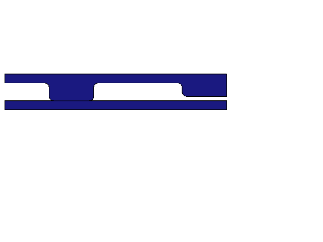

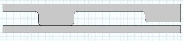

I've encountered an issue while simulating a contact pair between two bodies in Comsol, and I'm seeking guidance to resolve it. My model comprises two bodies, one with a well-defined contact area and the other with a noticeable gap between them. Both bodies are made of steel, sharing identical material properties. The contact formulation is set to use a penalty method. Post-simulation, upon reviewing the animated view, I observed that the contact appears to overlap on the side where there's a gap. I suspect this discrepancy might stem from solver settings or possibly an oversight in my approach that I'm unable to identify. Interestingly, when I reviewed a similar model on the official Comsol platform, the contact exhibited no overlap and appeared accurate. I've attached the geometry model and mph file for reference.

You are plotting a scaled deformation, not true deformation. I wonder why the bottom part is not fixed anywhere? You are also not sweeping the force, so I am not sure what COMSOL does internally. One contact pair might need to defined as 'In contact' initially, and the other as 'Not in contact'. Also, play around with Search distance. Hope this helps.
