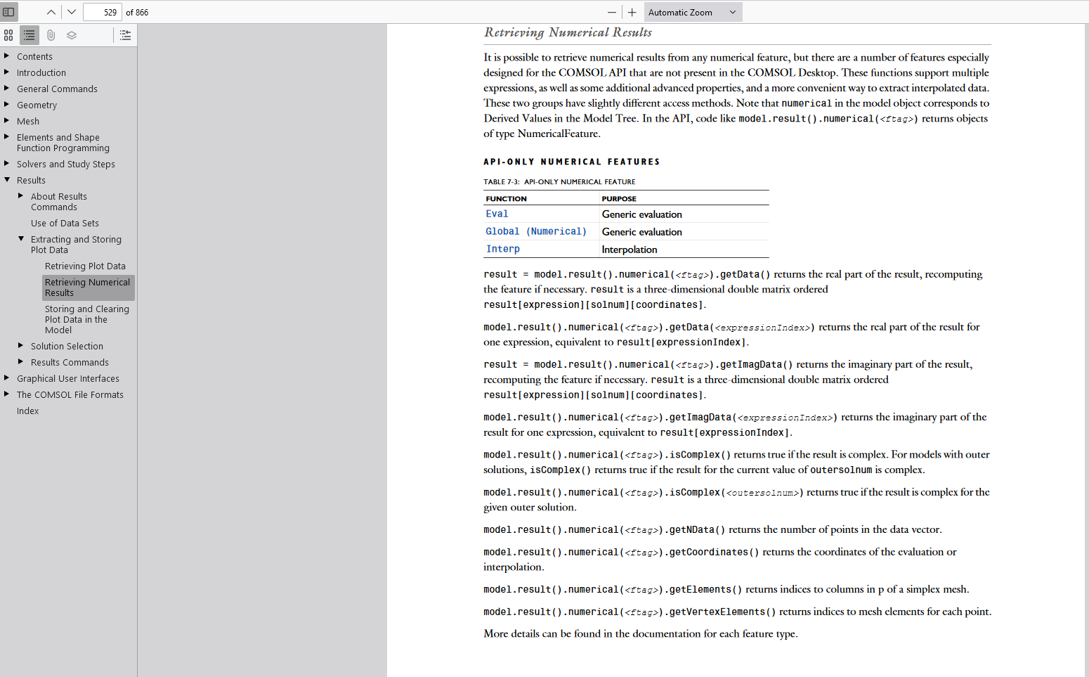

I am using the Java API to do some results post-processing on an electrostatics study. I came to a point in which I need to interpolate value of the electric potential at some specific point, but I cannot seem to find how to do that from the Java API documentation (alternative link)
In MATLAB Comsol, there is a function mphinterp which does exactly what I want. How can I replicate this functionality in my Java code?
Is it even possible to do that with the Java API only?
