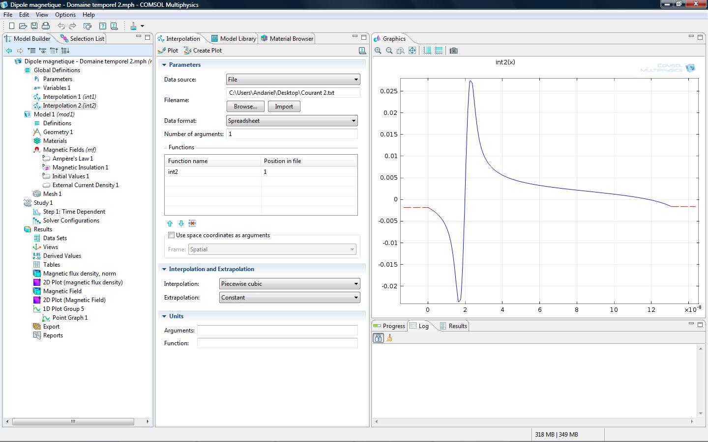

I've interpolated a gaussian current input from several points along time from 0 to 12E-8 (attached file).I'm exciting the loop using magnetic field (mf)'s external current density node along phi (cylindrical system) with "1[A]*int1(t[1/s]))/0.00000019635[m^2]". Note that I've declared "t" as a variable in seconds.

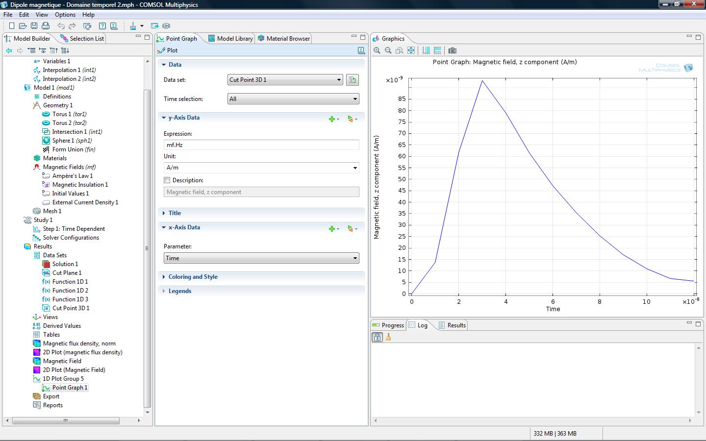

After running the time dependent simulation in "range(0,1.0e-8,1.2e-7)", I wanted to plot the magnetic field of a cut point located at 50mm (x,y and z) along time using the 1D point graph which, basically, must result in a gaussian curve too.

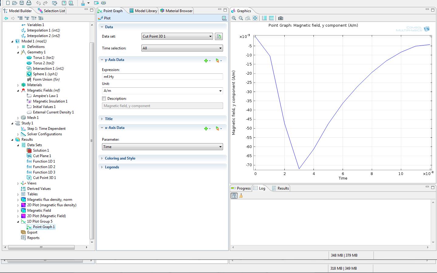

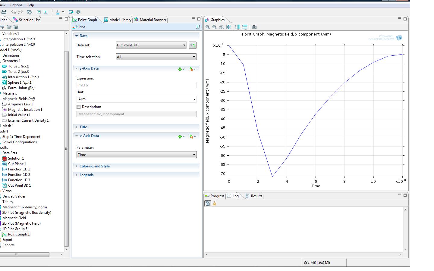

The problem is that I get a very different plot (not gaussian at all) with weird magnetic field values. Another problem is that the curve of the magnetic field with z component (attached) is different from the magnetic field, y component (attached) and also the x component, which I think should have been more or less the same according to my researches.

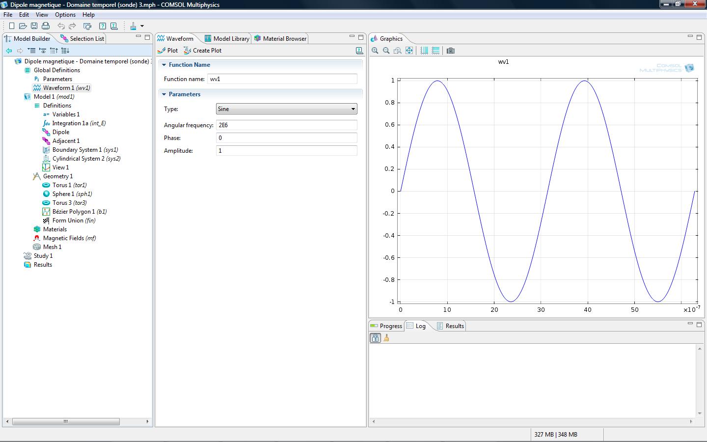

I used a Waveform excitation instead of the interpolation. I declared a sinusoidal current of 2MHz frequency and I excited the coil using "(1[A]*wv1(t[1/s]))/0.000019635[m^2]". Attached file.

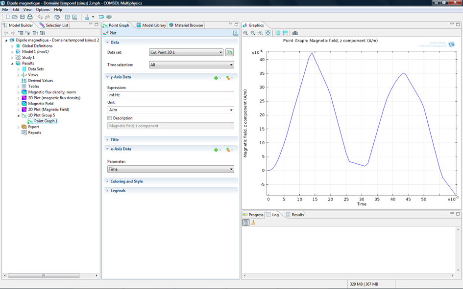

I run the time dependent simulation in the range "0, 10-7, 50 10-7". Still, the simulation output of the magnetic field doesn't match the output, even if it's closer this time, since I don't find a sinusoidal plot. Attached also.
What's causing the results to be this inacurrate, please ? Any indication could help me.

are you sure the physics is still valid for 2MHz and your model size ? ACDC assumes wavelength much greater than the model size, such that magnetic effects are "instantaneous w.r.t. the model. Normally the harmonic development and frequency domain solver is better suited for sinus type excitations

It seems you're right. I tested with a 2 Hz only excitation wave and it reasulted in a correct sinusoidal output. Like you said, it seems the wave's frequency in mega hertz is so high that comsol is assuming it's instantenous. So does that means that the magnetic field (mf) physics and all of ACDC just can't work for this excitation and that there's no hope nor solution ?

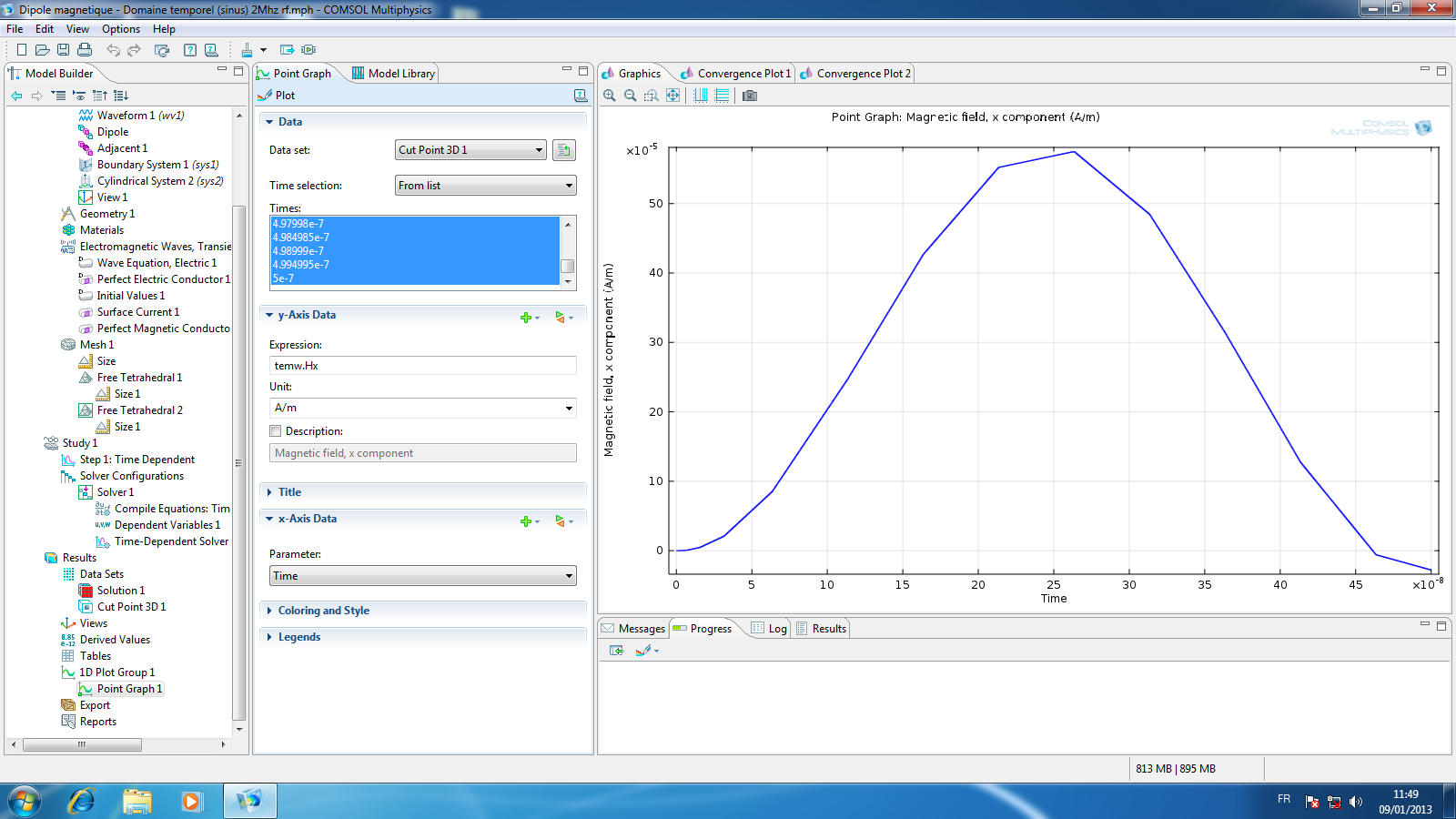

I decided to use the RF module, particularly the Electromagnetic Waves, transient (temw). I used a "surface current" node for the excitation and I specified "1[A]*wv1(t[1/s]))/0.015708[m]" [A/m] along phi inside the dipole, with the 0.015708 is 2*pi*dipole's radius. And a perfect magnetic conductor node for the air surronding the dipole.
The wv1 is a sinusoidal wave of 2MHz. And I simulated using time dependant study setting "range(0,5.0e-11,5.0e-7)"
Still, even with the RF module, the simulation output doesn't match the input since the field in fonction of the time isn't sinusoidal (attached). Even if, with this physic too, a wave of 50Hz does give an output corresponding to the input.
Is it a limitation from Comsol concernng the high frequencies or am I missing something ? Is there any solver configuration or any way to resolve this problem? Please help ?
I decided to use the RF module, particularly the Electromagnetic Waves, transient (temw). I used a "surface current" node for the excitation and I specified "1[A]*wv1(t[1/s]))/0.015708[m]" [A/m] along phi inside the dipole, with the 0.015708 is 2*pi*dipole's radius. And a perfect magnetic conductor node for the air surronding the dipole. The wv1 is a sinusoidal wave of 2MHz. And I simulated using time dependant study setting "range(0,5.0e-11,5.0e-7)" Still, even with the RF module, the simulation output doesn't match the input since the field in fonction of the time isn't sinusoidal (attached). Even if, with this physic too, a wave of 50Hz does give an output corresponding to the input. Is it a limitation from Comsol concernng the high frequencies or am I missing something ? Is there any solver configuration or any way to resolve this problem? Please help ?
