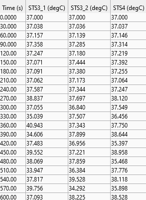

Unfortunately both suggestions don't work out for me. I tried really hard to create a swept mesh but am unable to. I always get errors. I read through the tutorial and tried to gain knowledge from the bipolar transistor example but I simply can't produce a swept mesh.
As for the time-stepping: Once I change it to 20 seconds (I also tried 10s), it produces very weird jumps in temperature, that are also not explainable. I attached an image of the table.
I would be very grateful for additional help.

I rebuilt the whole model step by step and found out that the weird results came by adding the vias. Because when adding the vias, I could not create a swept mesh anymore as the vias throw a "Unsupported topology of linking face" error.
That's why I exchanged the vias with cylinders with the same volume as the ring of the via. I can now create a swept mesh and get results that seem plausible.
This is not a solution however, just a workaround.
I rebuilt the whole model step by step and found out that the weird results came by adding the vias. Because when adding the vias, I could not create a swept mesh anymore as the vias throw a "Unsupported topology of linking face" error. That's why I exchanged the vias with cylinders with the same volume as the ring of the via. I can now create a swept mesh and get results that seem plausible. This is not a solution however, just a workaround.
