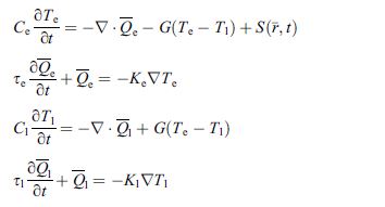

Now in the next step I am trying to develop a two temperature model of heat transfer. I am not getting an idea how to implement this using COMSOL. I have attached a file with the equations to be used in 2T Model.
Do you have any suggestion as in How should I proceed?

Yes it is one domain, let us say we have a material with some dimension in 2D. When it is irradiated with femtosecond laser pulse, it gets heated. now in order to do transient study of heat transfer phenomenon I need to consider both electron (Te) and Lattice temperature (Tl) of the system.We are using a volumetric heat source and consider Beer Lambart's law for laser absorption in the material.
I am not getting an idea like how do I handle this electron and lattice temperature in COMSOL?
is it so simple that I should add twice the Heat transfer Physics with time dependent study and couple those 2 physics for the same system?

I would consider this yes, two HT, one for each species, but you need some good linking expressions since the physics of both must couple somehow, as its the same "material block"

In order to coupe those two species I am using electron phonon coupling factor. I should look for a way to couple it.
