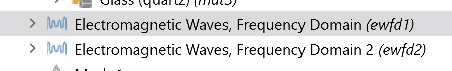

Hi, I am using Wave Optics Module and I have created a simulation with 2 different electromagnetic waves, ewfd1 e ewfd2 (capture.PNG)
Is it possible to add a third electromagnetic wave ewfd3, without re creating the simulation?

Sure you can add another physics node. You need to setup another study in the model to run that physics and get another result dataset.
