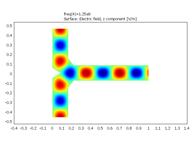

Actually, you CAN have multiple active input ports. I do it all the time and it is useful for computing how fields combine in microwave systems with more than one input. However, when you turn on more than one port at once, the S-matrix components will not be made available to you explicitly in the post-computation list of available quantities. Nevertheless, you can still construct the input and output powers, and you can certainly observe the phases as well, by means of defining integrals at each port of interest and/or plotting fields at points on the ports.
An example of a rather trivial case (combining 2 waveguide inputs in 2D) is presented in an animated .gif file (prepared with the old Comsol 3.5a) attached to this message. Just open and view it in your web browser to see the animation.

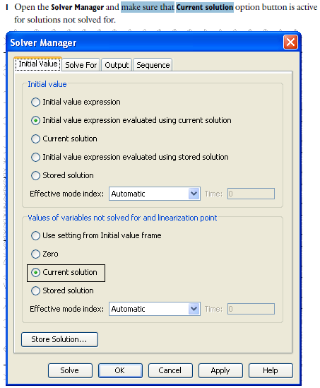

Posted:
1 decade ago
07.10.2013, 12:23 MESZ
I think I solved my and your problem : go to page 59-62 of the User's guide of the RF module.
I attached an image, because the manual isn't perfectly clear.
