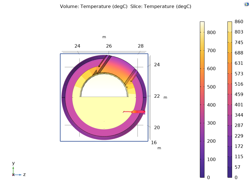

Hi everyone,
I'm new to comsol. I want to simulate the Pierce Smith converter heat transfer. Its basically a tube with multiple layer, the heat should be from high temp - low temp. The layers are: -Slag : 860C (fluid) (hotest, heat source) -Brick (solid) -Steel (solid)
i've tried solid and fluid heat transfer, but the result is weird (all purple) or there's a color gradation but the result is only different by 0.1C.
Please show me the tutorial to simulate it properly
note: The 3D model i used is from inventor, i linked it with comsol
