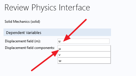

Displacement Field Notation: Potential for Confusion in Solid Mechanics?
In the solid mechanics module, wouldn't using one symbol for both the displacement field and the first component of the displacement field cause confusion?
1 Reply Last Post 12.03.2024, 10:41 GMT-4
Posted: 3 years ago 12.03.2024, 10:41 GMT-4
There are several physics interfaces in COMSOL, not only in the realm of structural mechanics, that have this property.
I agree that it may look confusing, but in practice there will never be any ambiguity. It is very seldom that you need to enter a field name, and in those cases, only a field name will be accepted.
Henrik Sönnerlind
COMSOL
There are several physics interfaces in COMSOL, not only in the realm of structural mechanics, that have this property. I agree that it may look confusing, but in practice there will never be any ambiguity. It is very seldom that you need to enter a field name, and in those cases, only a field name will be accepted.
