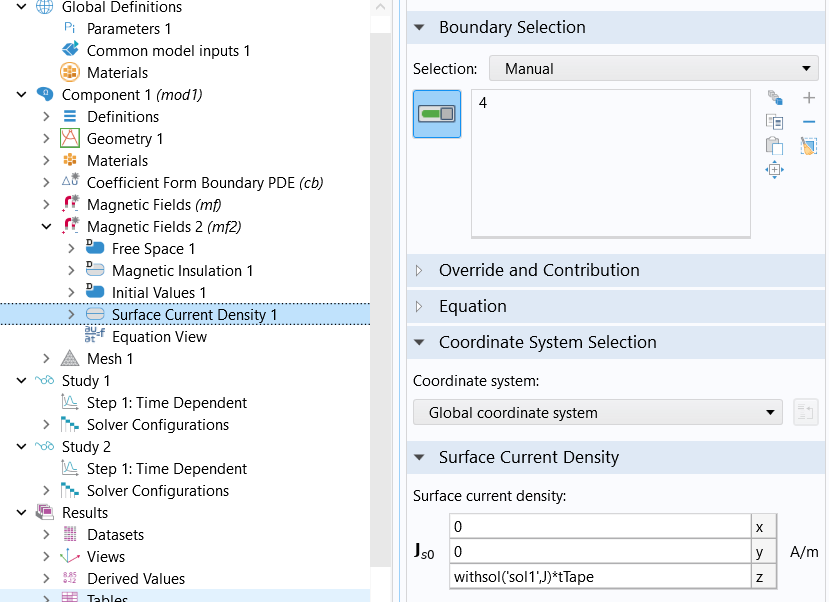

I have two time dependent studies in my simulation. In the first, solved with a time interval defined as "range(0,1/f/100,1/f), I obtain the time variation of the variable "J" and solve the physics "cb" and "mf". Then I would like to set the J(t) results from study 1 as an input parameter in study 2 where I solve only for "mf2".
To do this I tried to impose the function "withsol('sol1',J)tTape" (tTape is a thickness) as visible in the figure but with this definition Comsol does not take into account the temporal variability of J; it is as if Comsol took J's solution in a single instant of time.
How can I define the "withsol" function so that I can take the values of J at all time instants and use them in study 2?

I had already seen these functions (setind and setval) but from what I understood, as you also reported, they allow you to define the withsol function only at certain moments of time or for certain values. For example withsol('sol1',expr,setind(p,2)) refers to the second time instant, right?
What I would like to do is something like ('sol1',expr,setind(p,All_timestep)) where the values of p at each time step are taken into consideration. Is it possible to do this and how should I write the withsol function?

Ah. If neither setind or setval work satisfactorily in this context, you may need to set up some kind of separate interpolation operation. (Note: According to the Help system, the use of setval in the withsol operation will support interpolation.) But I'm not sure if you might be having some kind of time-variable-naming issue. In principle, you could export the results (for J vs, time) of one run and then import those results into an interpolation function to use with your boundary condition in a subsequent run, but I suspect a less cumbersome approach exists. Perhaps another user, or Comsol employee, can suggest a more elegant solution?
