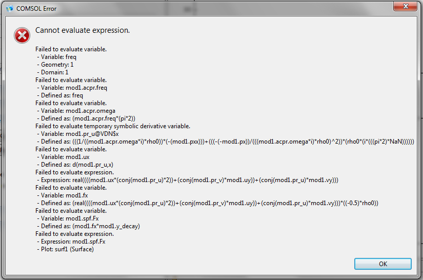

I'm new to using the v4.x series of COMSOL, so perhaps I've missed something simple, but I get an error when trying to plot body volume force variables. The error message states:
"Cannot evaluate expression.
Failed to evaluate variable.
- Variable: freq
- Geometry: 1
- Domain: 1
- Variable: mod1.acpr.freq
- Defined as: freq
and continues down to mod1.spf.Fx which I am trying to plot (see attached image).
I have used the Pressure Acoustics module along with the Laminar Flow module. I set the solver to first solve Pressure Acoustics in the frequency domain (Step 1), then a combination of parameters from Pressure Acoustics is used to calculate body forces in the Laminar Flow module. Stationary analysis is used to solve for the Laminar Flow physics (Step 2).
Has anyone had this problem before? Is there an easy way to fix this problem?

Have you defined the frequency in the first tab in the frequency solver node ? I suspect your field is blank

Under Global Definitions>Parameters, define variable “freq” and assign the same numerical value of the frequency you are using in the Study Step.
Update the model and plot your results again.

Thanks for your help and apologies for the delayed reply. The trick of defining a new parameter "freq" under Global Parameters worked.

probably the same effect as when you run a stationary sover before a time series, with BC equations depending on "t" the time, but "t" is defined only when the time dependent solver is active not during the stationary solver, therefore one must add the variable name as a Parameter (typically t=0[s]).
For the frequency domain, "freq" is defined when that solver is active, but not for any other solver, so you need to add it in the Parameter list too.
A Parameter might be overwritten later by COMSOL as a parameter is loaded once at first solver run and only updated via a "Parameter sweep" or "Continuation sweep" sovler node

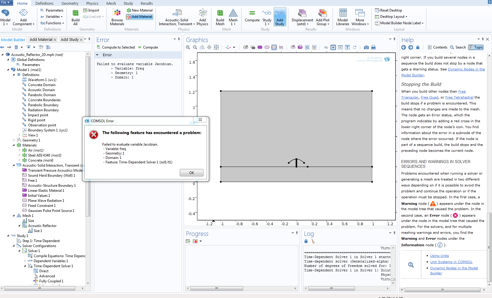

I think I have the pretty similar trouble as the one you solved. Could you take a quick look at the attached file and help me fix the problems.
Thanks in advance on your comment.
