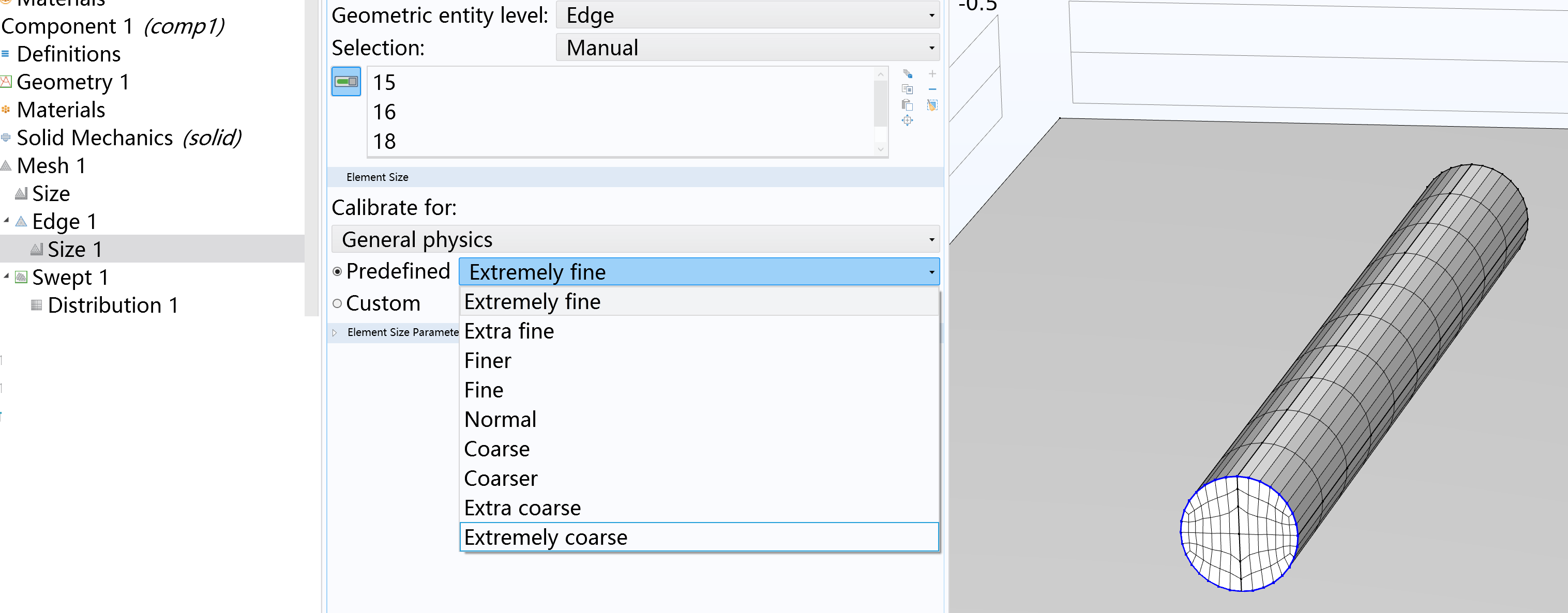

Posted: 1 year ago 13.04.2024, 03:36 GMT-4
Hi Magnus, Thank you so much. I followed your advice but found that Edge 1 and swept 1 don't play well together. I specify first the mesh density to be extremely fine in Edge 1, then specify the element numbers swept 1, the latter overthrowing the former.

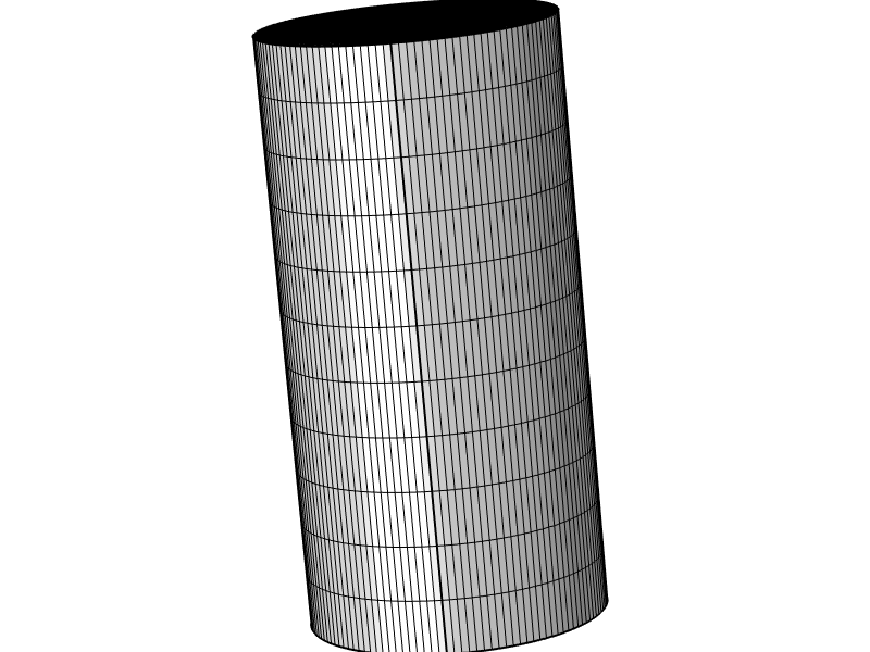

Hi Magnus, Thank you. I can't see your cross sectional meshing clearly enough. Isn't it axisymmetric?
Magnus Ringh COMSOL Employee
Posted: 1 year ago 16.04.2024, 03:58 GMT-4
Hi Carl,
The mesh nodes are evenly distributed along the base (and top) perimeter, and by default, the bottom surface uses a quadrilateral mesh, and the cylinder is swept meshed with hexahedron mesh elements. If desired, you can instead use a triangular mesh on the botton surface; the swept mesh for the cylinder then uses prism mesh elements.
Magnus
Hi Carl, The mesh nodes are evenly distributed along the base (and top) perimeter, and by default, the bottom surface uses a quadrilateral mesh, and the cylinder is swept meshed with hexahedron mesh elements. If desired, you can instead use a triangular mesh on the botton surface; the swept mesh for the cylinder then uses prism mesh elements. Best regards, Magnus

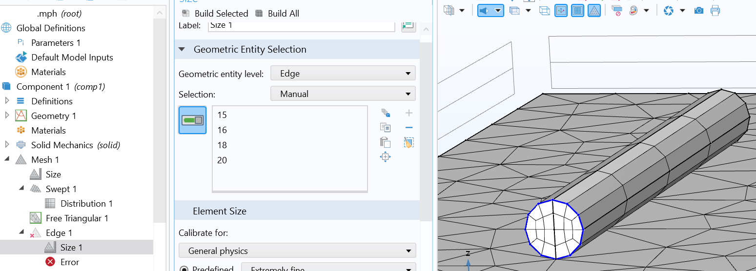

Posted: 1 year ago 26.04.2024, 23:30 GMT-4
Hi Magnus thank you. I followed your advice as attached. The only weakness for me is that on the circular boundary the mesh is too biased. Is it possible to build one that is not so biased in the two perpendicular directions?
