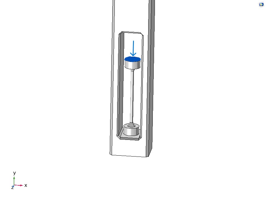

Im working on the same system I need to put a no rotation constrant on the top face of the lower flexure.
I added the image of the location of the no rotation constrant and a pdf of the system. In addtion I attach the mph file of the system.

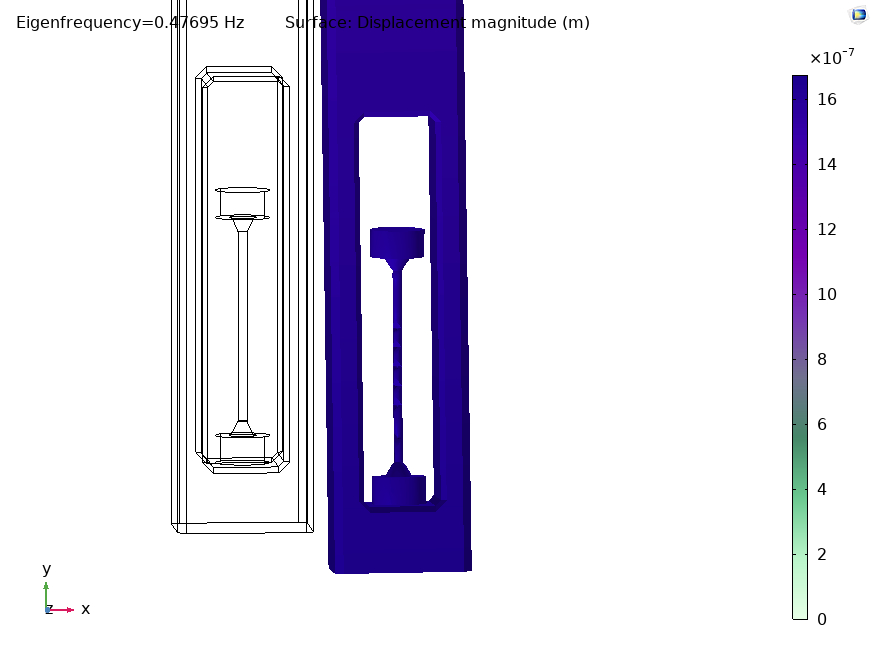

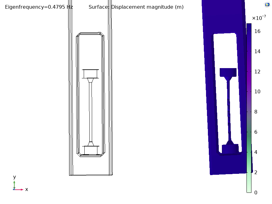

What i did was I use a rigid connector at the location and constrant it rotation however I suspect it does not work correctly because in the first 2 mode the flexure is not bended correctly and the system was not rigid.
If there an another way to put a no rotation constrant on the solid mechanics interface that will be perfect.

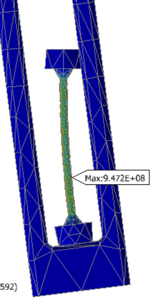

For the system I don't want any sliding i just want it to be able to move in all direction (x y and z) but not able to rotated in the x y and z( the result im looking for is in this image) for the Symmetry condition does putting a free displacement work?
