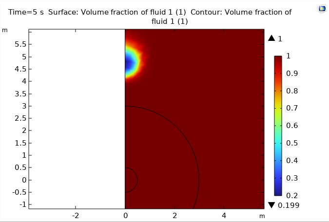

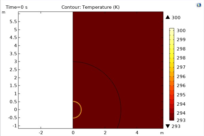

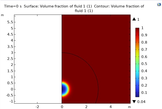

Hello, I am quite new to COMSOL Multiphysics, currently modelling a multiphase flow using level set. I want to integrate Heat Transfer between the 2 fluids, however, when I apply the temperature boundary condition to the initial interface between the fluids, after some time the position of the interface of fluids changes but the temperature remains at the initial interface. How to I couple Level Set and Heat Tranfer in Fluids such that the boundary of temperature boundary condition changes with the changing fluid interface.
