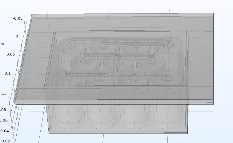

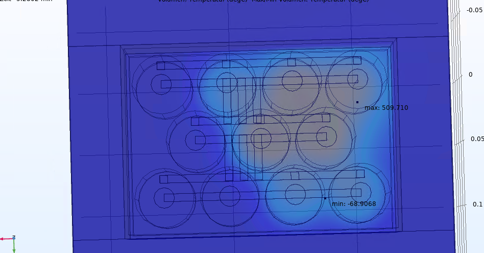

Hello Jeff,
thanks for your reply. I have attached some screenshots which might help with visualising the problem at hand. If you need any further screenshots to identify the problem let me know.

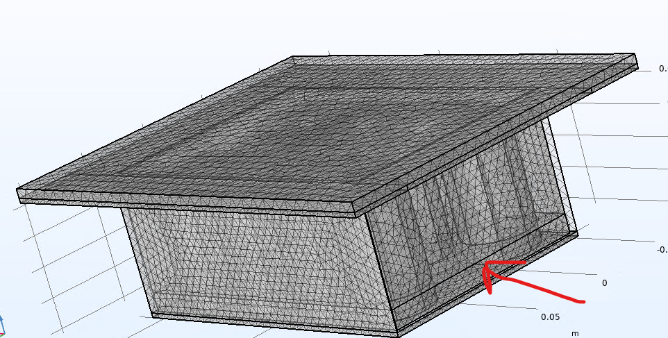

The red arrow indicates the area where the negative temperatures appear (within the holder).
Also note how the negative temeperature "jumps" within the holder when the fire propagates from one cell to another.
Also interesting to note might be the fact that the picture shows a mesh that I have built with minor tweaks to the physically constructed mesh. I have so far used the physically constructed mesh and the minor changed one. I doubt that might be the reason for the negative temperatures but I thought I would mention this.
