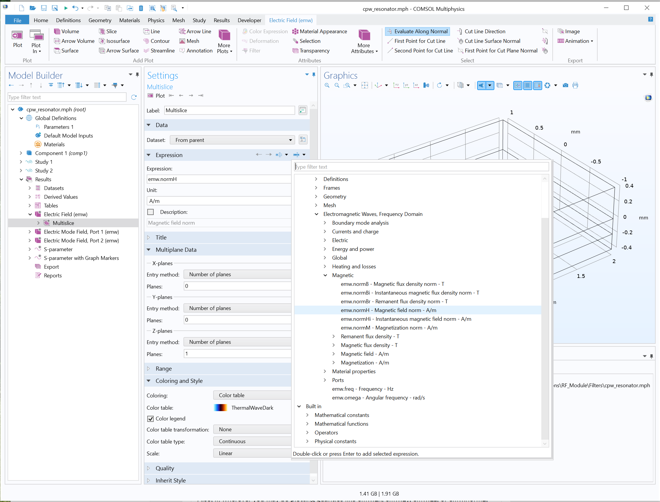

As Comsol suggests: "If your MPH-files are large, you can greatly reduce their size by selecting Clear All Built Meshes from the Mesh menu and Clear All Solutions from the Study menu, and then saving your MPH-files." Please try that.
Also, if/wherever you may be plotting quanties like emw.Ex, emw.Ey, emw.Ez, or emw.normE, consider simply replacing those by emw.Hx, emw.Hy, emw.Hz, or emw.normH.
You can also select these from various post-processing menus. E.g., see image attached, from one of the Comsol-supplied cpw examples I mentioned.
