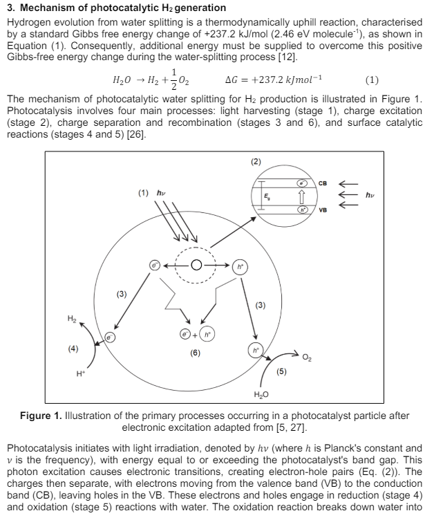

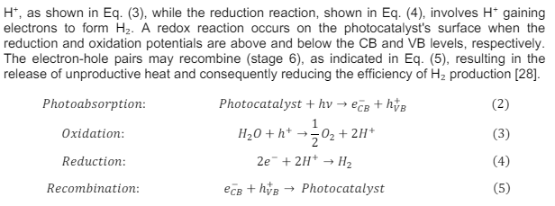

Hello everyone,
I would like to ask for some guidance or ideas on how to approach the topic of "Solar Photocatalytic Generation of Hydrogen" specifically in the analysis of the kinetics and mechanism of the reaction. I have reviewed some examples of heterogeneous catalysis, transport of dilute species and surface reactions. However, I consider that it might be too complex for my master dissertation which should be a basic/simple model.
I am also confused about how to couple the Ray Optics interface with the Chemical Species Transport nodes.
I appreciate your help,
Paola Suarez.
