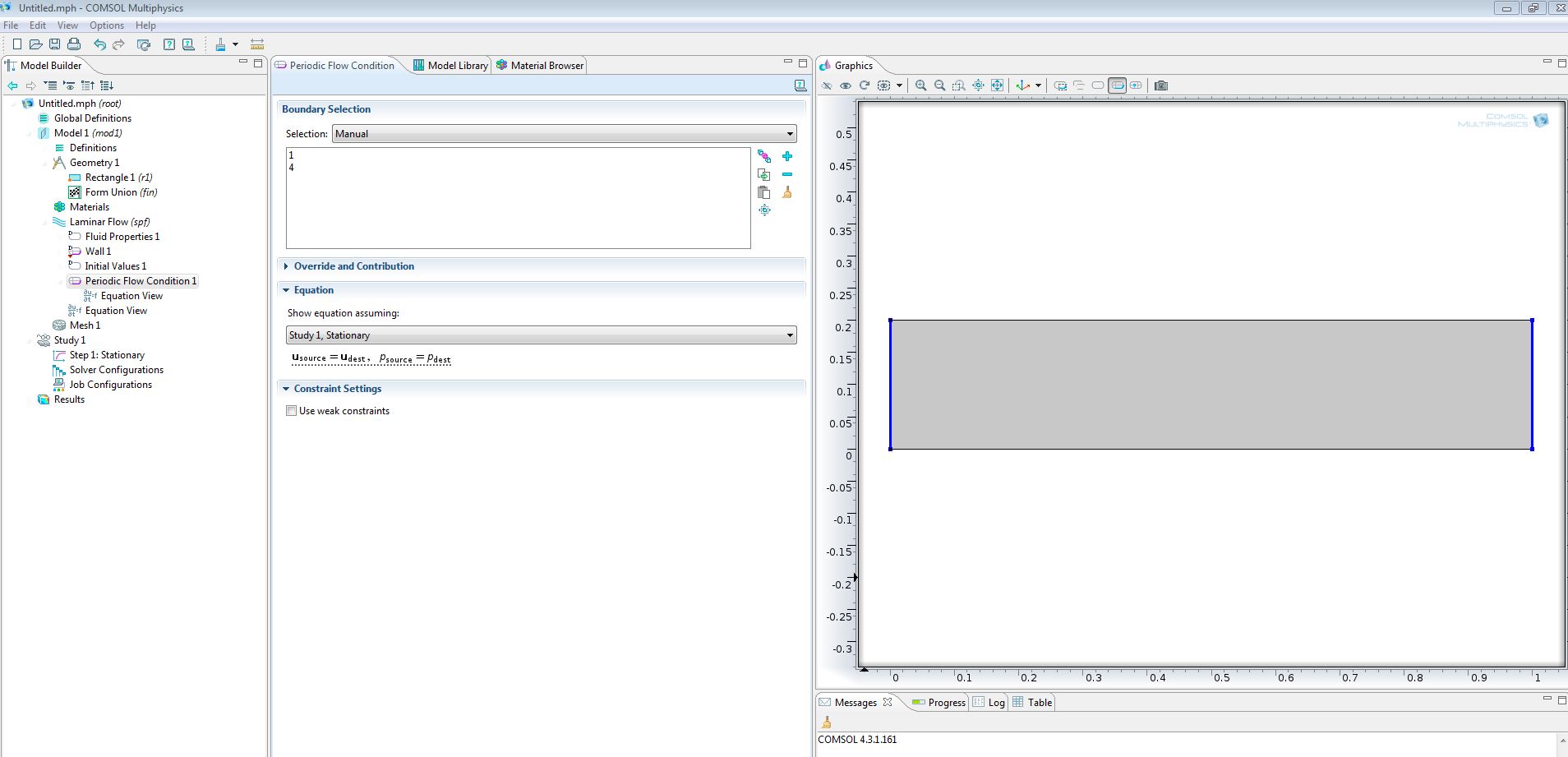

Here is what I see
Here is what I see -- Good luck Ivar

Ah, ok, but youre using the fluid flow physics! We have it as well, but so far I have my problem implemented in the PDE mode and are generally quite happy with it. And there only usource=udestination appears as equation, so nothing said about the derivatives, right? So in tha PDE mode, I could just define myself a second periodic boundary condition, where I type as expression the flux by hand, no?
