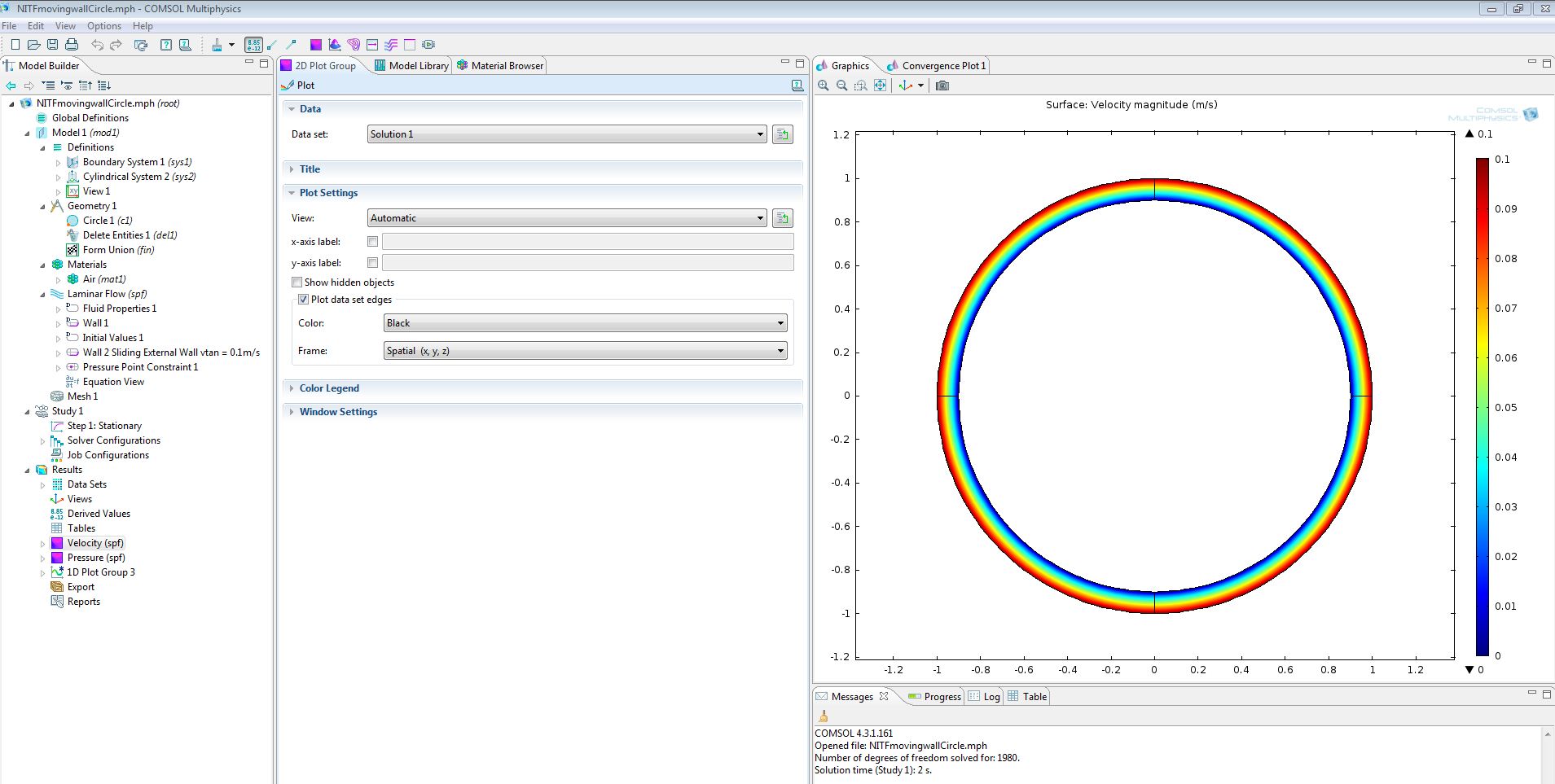

here is a screen view, very simple set-up (oops have a Opera <-> Java update issue cannot upload from here anymore, checking with IE)

just had some minutes to take a closer look, My main question: why do you add HT and NITF as the latter contains all HT anyhow, no reason for doubling up, and now you need to equate the two T that represents the same dependent variable ?
And for the cylindrical coordinates, add a Definition cylindrical coordinate system, then you can refer to the components sys2.r etc, instead of the full equations, unfortunately COMSOL has not foreseen that you add your own coordinates system to define the mowing wall, sad, it would be so much easier ;)
And I would avoid the variable name omega, as it's used by COMSOL for frequency domain and other solvers, use rather some "omega_" or "my_omega"
I cannot get any arrow plot to show up, anyhow you must ensure that t>0.2 to avoid the rect is sending all velocities to =0
