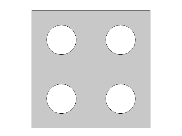

What Comsol options should I use to properly define periodic boundary conditions (PBCs) for solids with uniformly distributed cylindrical holes? Unit cell is presented in: (unit-cell-1, unit-cell-3)

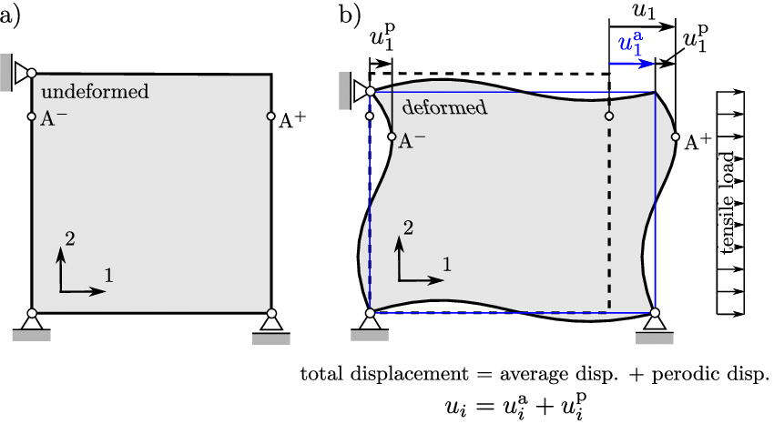

In second example deformed unit cell is still cubic box.
Sometimes it is not possible. See attached figure unit-cell-4.
How to make boundaries deformed after PBC will be applied with loads?
