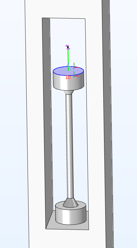

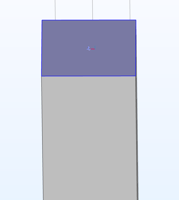

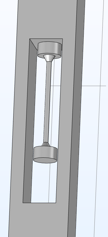

I did a stationary study on comsol to get the displacement on the bottom flexure top face here was the set up 1. Upper and lower flexure with the beam 2. Anisotropic silicon [100] 3. Added mass at Top of the beam: 0.9 kg 4. Added mass at the top face bottom flexure: 50kg 5. Fixed constant at the top flexure bottom face 6. No-rotation constant at the bottom flexure top face 7. Boundary load: first test 0.5 N then second test 0.005 N both test at bottom flexure top face both in the x-direction 8. Gravity is on first test. Gravity is off on the second test 9. Study is static study 10. Use a probe at the bottom flexure top face to grab this displacement value.
i got the displacement on the bottom flexure top face and it 0.323 m is this correct?
