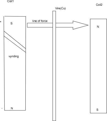

It is difficult to understand what problem you are trying to solve. Seems that you want to model coil motion but velocity term is not defined in your model.
1. Magnetic field is not spreading out because you are imposing Magnetic Insulation boundary condition at the coil boundary. So, remove this BC.
2. You are using 2D geometry which is confusing. Is not your coil circular? Then, you need 2D Axisymmetric geometry instead of planar 2D.
3. Increase air domain size around coil and wire.
4. It is not clear why you are using Form Assembly feature?
Sergei
Martin,

Sergei Yushanov
Certified Consultant
Posted:
1 decade ago
25.01.2013, 22:01 MEZ
Martin,
BC stands for “Boundary Condition”.
In order to help you, please, provide the description of the problem you are trying to solve along with the sketch of the system.
Sergei

Posted:
1 decade ago
25.01.2013, 23:38 MEZ
Thank you for your willingness.
In the picture there are 2 coils and electrical wire in the middle.
And I needed to know as I do that the geometry of the electrical conductor moving in the direction and strength of the magnetic field.
But so that the movement was visible and that each field to themselves really worked.
Rush preto.že 29 jan.2013 my license expires on the trial version.
Thank you very much for your help,
Martin Kandl.

Ivar KJELBERG
Posted:
1 decade ago
26.01.2013, 01:47 MEZ
but are you in 2D (infinite long) or 2D-axi (but then where is the axis ?
Why not start with two magnets or just boundary flux values ?

Now back to your question about a moving wire in an magnetic field. I do not fully understand what you are after, with your model, to show the principle, or to test ALE meshing, or ...
The way you have drawn the N-S of your coils I do not se how you loop the current in 2D, and if your wire is vertical along Y and the current flow therein is vertical, then it's aligned with the flux lines, and you will have no forces on your wire.
But even if you had some forces, why should it move ?, it's position is governed by x,y or x=u+X, y=v+Y, but you are not solving for the displacement u,v, only for the magnetic vector potential Vm in ACDC 2D.
Furthermore ACDC is tricky, the Maxwell eqations with the curl mixes all 3 coordinates, even if you are studying only 2 such as x,y in 2D, you need to look into the "z" components, because of the curl terms.
You have the rotary motor example in the model builder. It's worth to modify it and make a linear motor in 2D-axi (moving along Z the vertical axis in 2D-axi, and then you could try the example with the wire in a field, but be sure you get your field as desired, and the current flow too ;)
