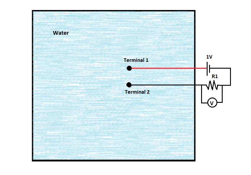

1. An electric pole is placed underwater
2. A circuit is built around it to measure the voltage drop across a resistor
The setup can be better understood from my schematic that I have attached.
I have done the first part in which I ran the Electrostatics Physics and got the potential plot. From different posts in this forum I was able to make a little headway into the second part, but it does not work. I assigned two terminals 1,2. Added a voltage source between 1 and 2. Added a External I vs U between 2 and 3 and then a resistor of 10000 ohm between 3 and 0. When I try to solve this, I get the following error
Errors during multiphysics.
The DAE is structurally inconsistent.
- Variables: 2
- Equations: 0
I have attached my files.
The reason may be that the two terminals are not connected. But the water should technically close the circuit. And there should be a reading on the voltmeter. I have verified this experimentally to be of the order of 300 mV. But COMSOL does not solve my problem. Is there something that I am doing wrong or COMSOL is not designed to solve such a problem.
Any help will be highly appreciated. Thanks.

There were two problems in your setup:
1) The circuit was not connected to the Electric Currents interface. The External I vs. U node should be used to make this connection. The voltage specified on this node should be equal to the potential difference between the two electrodes.
2) The circuit components did not form a closed circuit.
The implementation is simplest if one of the electrodes is grounded. See the attached file for a corrected setup.
