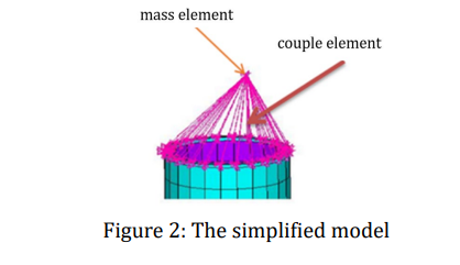

HI, i m trying to attach mass and inertia to a reference point(top diameter of hollow cylinder) that does not have a material property and does not belong to my geometry. i attach picture and comsol file of how should look like the geometry and what i would like to achieve. I 'm using linear elastic model but mass and inertia it's only in rigid model. how can i connect the mass point to the boundary of my structure.

Perhaps you are looking for 'Connections'->'Rigid Connector' with added (Right-click) 'Mass and Moment of Inertia'?

The easiest way is to use a Rigid Connector attached to the outer boundary. Then, add a Mass and Moment of Inertia subnode. If this coupling is too stiff, you can set Connection type to Flexible. The best choice would be dictated by how that extra mass is attached in reality.

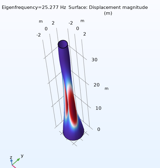

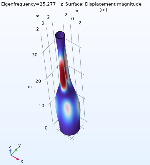

thanks so much both, i SOLVE IT, but when i plot the eigenmode of the structure i have very unrealistic mode shape since the cylinder get squeeze or stretch. Should i add constrain to maintain the cross sectional area fix? how?
I attach picture and file to have a better rapresentation
thanks so much both, i SOLVE IT, but when i plot the eigenmode of the structure i have very unrealistic mode shape since the cylinder get squeeze or stretch. Should i add constrain to maintain the cross sectional area fix? how? I attach picture and file to have a better rapresentation

I don't see any issues with it. What are your expectations to the modes? Do you have any analytical expressions to compare against?
Posted: 11 months ago 09.09.2024, 11:20 MESZ
It seems like you are looking at a higher order mode. Check if the first natural modes match your expectations.
Posted: 11 months ago 09.09.2024, 17:29 MESZ
Comparing my mode shape with the one presented in a paper, the first two mode are the same, but from the third one they all look different. For example as i show in the picture in the previous message i should get a torsional mode instead of a "squeeze" or collapsing mode. Since it's a hollow cylinder it 's quite unrealistic,for the simulation of a wind turbine tower, that the cross section area of cylinder get so compressed(imploding ). it should apprroximately maintains the same circular cross section. Any insight?
Posted: 11 months ago 10.09.2024, 09:09 MESZ
Calculate more frequencies. I see a torsional mode at 35.837 Hz.
Posted: 11 months ago 10.09.2024, 10:25 MESZ
They might not show in sequential order in the paper, but selected for their narrative.
