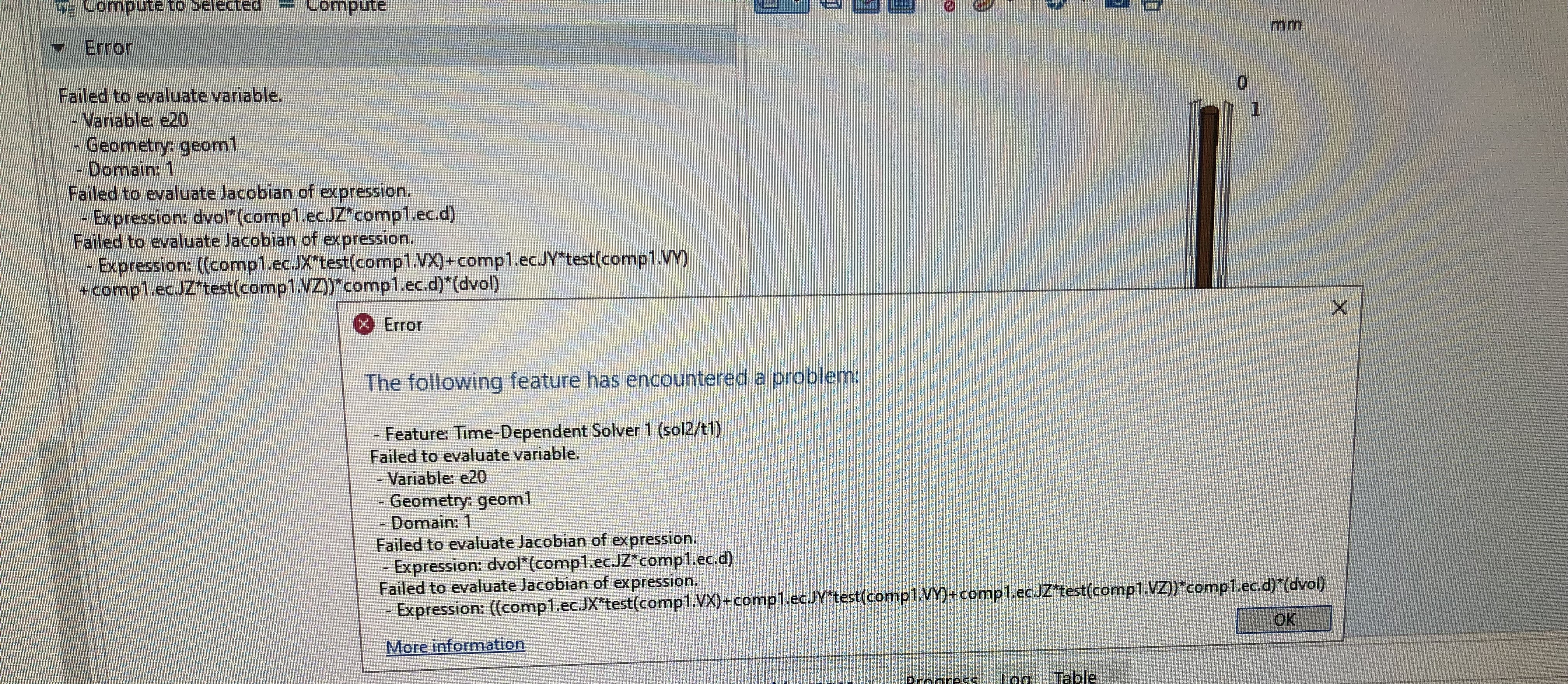

I am trying to solve HT and AC/DC for wire inside EMC. I have 2 domains one for EMC and 2nd for Wire.. I am getting an error when I use time dependent solver, I get an error as attached.. The error is only when it is time dependent study.. I am using convective heat flux under the option of HT through solids for wire..

You may like to verify that all terms appearing in the expression for e20 are defined and Comsol can evaluate it.
