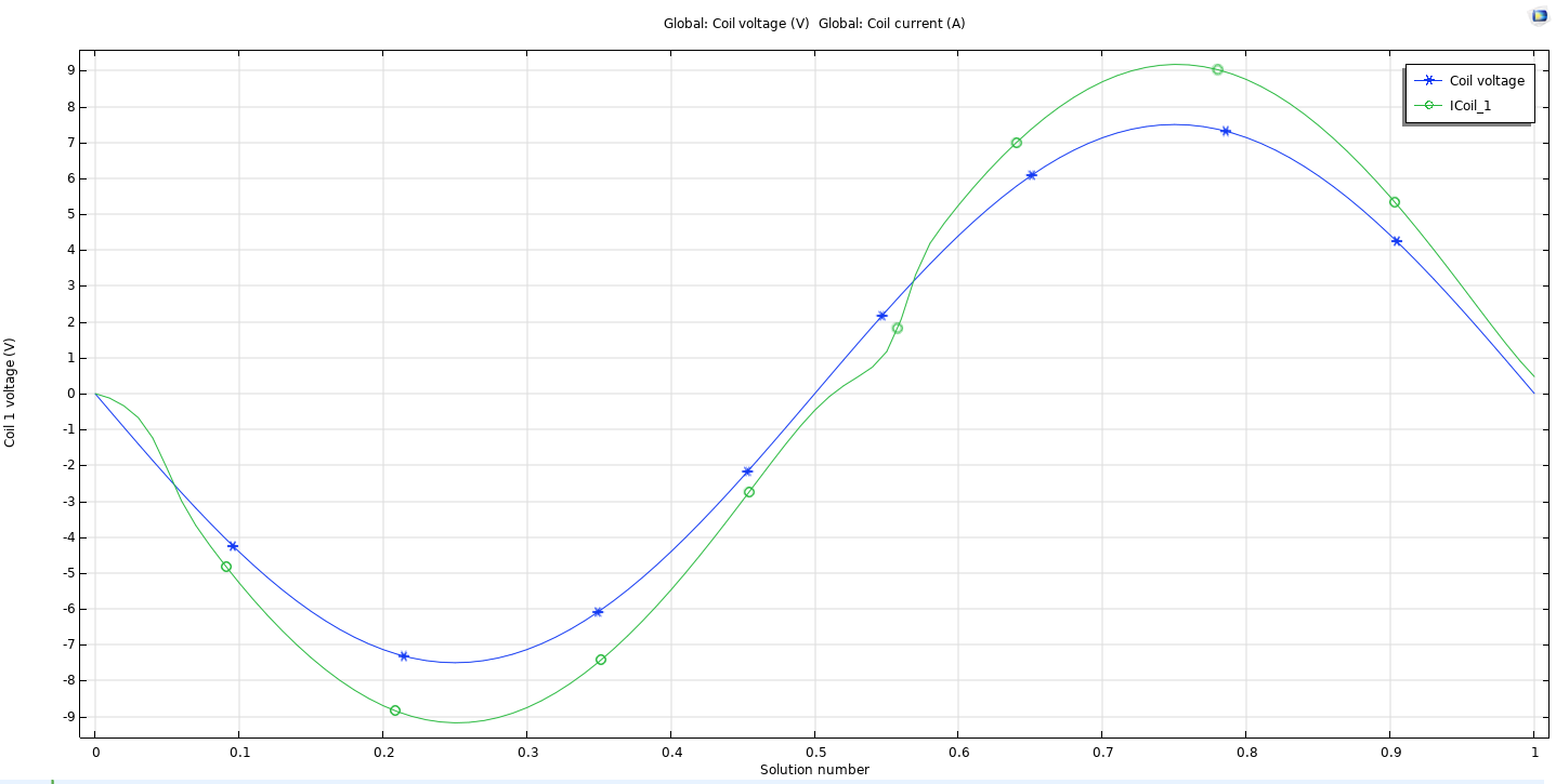

  1. The EM sensor operates similarly to a transformer, where the primary and secondary coils are coaxial. When I apply a sine wave input (in my case, a 1 Hz sine wave) to the primary coil, the current waveform in the results does not maintain the same shape—it appears slightly altered. Could this be due to the inductance effect? Does COMSOL automatically account for inductance in the circuit without the need to explicitly define an inductor component? However, I am unable to find this information in the result expressions. (relevant image attached)

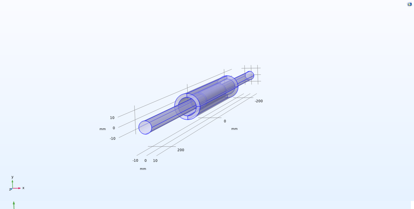

  3. Lastly, in the attached image, the core is surrounded by two coils. The core's dimensions are a radius of 6.5 mm and a length of 500 mm, while the coil diameters are set to 1.2 mm and 0.5 mm, respectively. Would it be sufficient to use Physics-Controlled meshing with a Fine or Finer setting, or should I opt for a more refined mesh for better accuracy?
