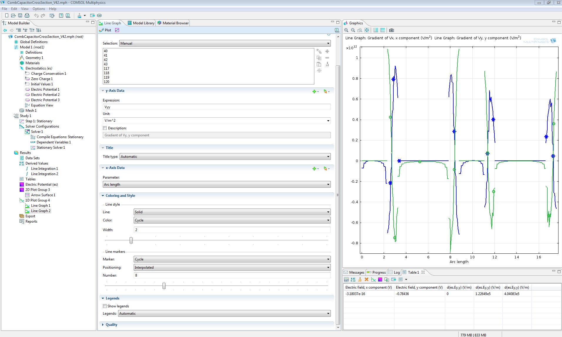

in my 4.3.a I get non zero values (where you seem to get "0", strange), now you need to take the side parts too, ideally the full finger turn
But on the other side if you plot Vxx and Vyy along the entire loop around your "finger section" you get quite some spikes that will give you rather large errors see below.
I would propose to increase the discretization (turn on in the view mode) for V
