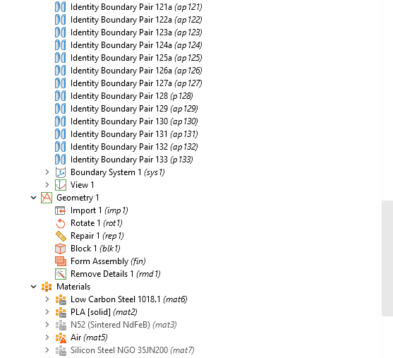

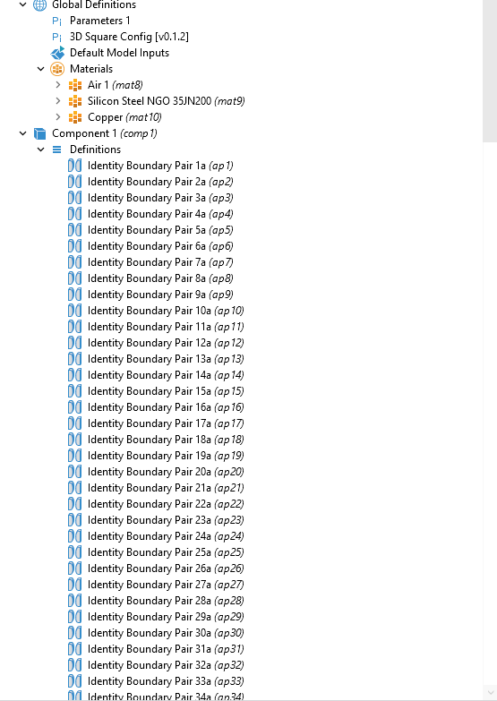

Given that, I went and checked under "Definitions" to see the Identity Boundary Pair, and it made pairs between each of the components in the assembly. After running it again (where the Magnetic Insulation is still selecting everything inside the box), I run into the same issue. I then try to implement a Continuity Boundary in the Magnetic Field's interface, and I see that all of the components inside aren't selectable (it says "not applicable"). So i then try to select all components inside of the box and add a Magnetic Field's boundary condition, assuming that COMSOL will recognize that if I keep the initial parameter of the boundary condition of the tangential magnetic field to be zero, it will allow the magnetization to conduct in the material.
I either get an error message that says: Divergence cleaning failed for Auxiliary-Space Maxwell (AMS), or I run into the same issue where the magnetic flux doesn't permeate out of the material inside the box of air, and the magnetic field is still around the value of E-16 Teslas (essentially zero).
I even tried creating my own identity boundary between the model inside the box and the box itself (where I selected everything inside the box as the source, and the destination as the box, as well as vice versa, and it still doesn't work)

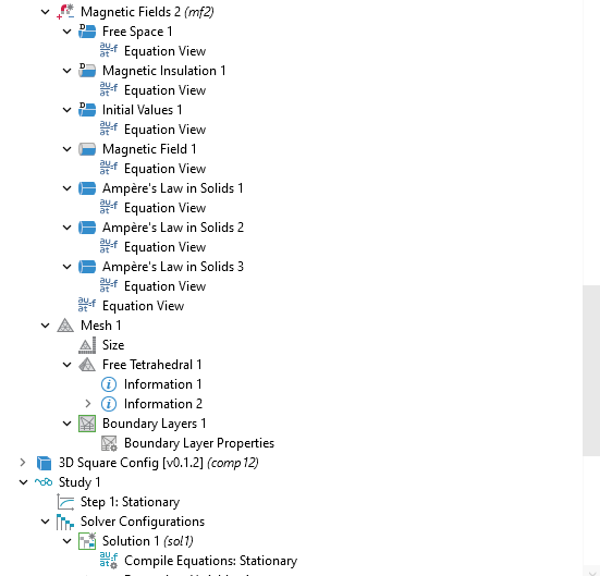

I attached a picture of my Model Builder Hierarchies, however, I'm not able to link my COMSOL model due to privacy concerns. Could anyone help me?
Edit: I have one section of my model to be a magnetization-based solution, so i set the magnetization myself, and another section is to be influenced by such magnetization, which i set the magnetic properties to be the material's relative permeability. When i run it as is, I get the AMS error mentioned above. When i set both components to be magnetization, it runs fine but it's not what I'm looking for. I have a hunch its an issue between the boundary conditions. Could anyone help me solve this issue?
