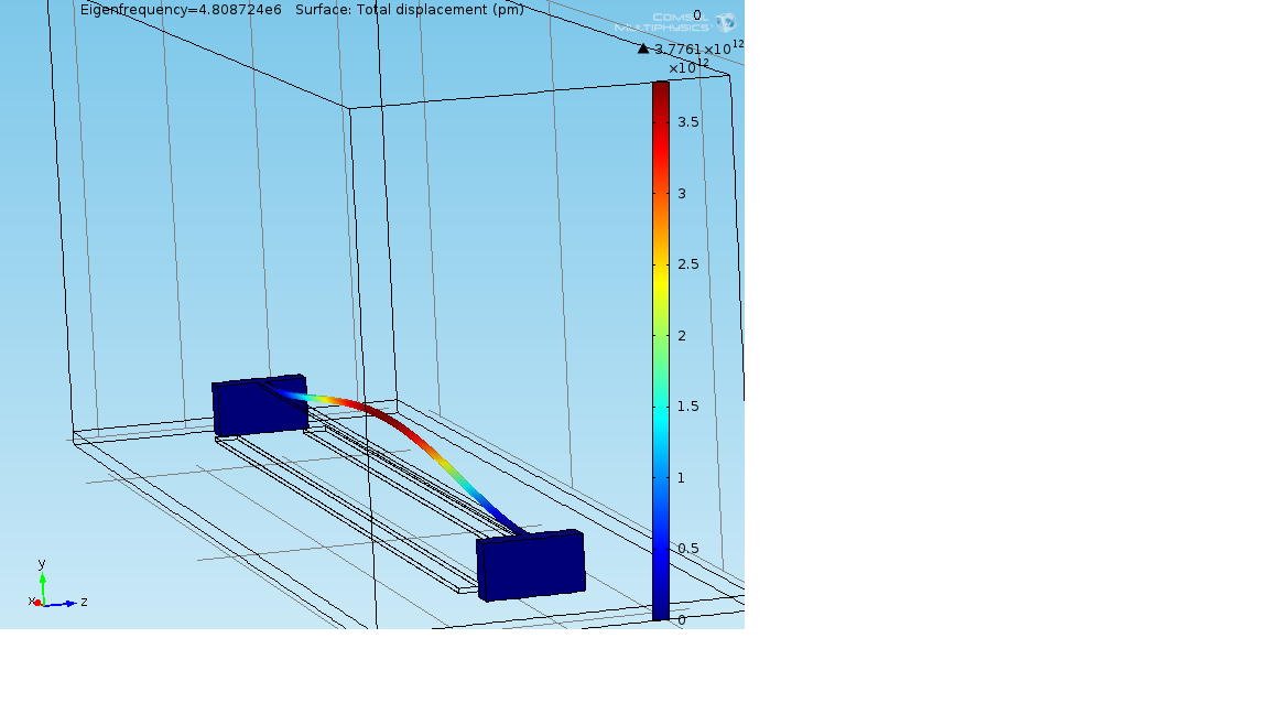

Eigenfrequency seems right, but displacement units are totally wrong.
Dear Comsol Community,
in the model attached I have a 20 micron long beam using the Solid Mechanics module to get the Eigenfrequencies. I calculated them manually using Euler-Beam theory and the first Eigenfrequency should be around 5 MHz.. Comsol calculates 4.8 MHz. I thought great result, but if you look carefully at the screenshot, you will notice that Comsol claims the displacement is on the order of meters, which is totally wrong (it is rather pico meters). I feel I am missing something fundamentally, but I cannot get Comsol to spit out the correct displacement as well. (Scaling or anything of that sort is disabled).
Thanks for advices!
Erik
14 Replies Last Post 27.01.2015, 00:49 MEZ
Posted: 1 decade ago 08.02.2013, 06:12 MEZ
Hi Erik,
In a mode shape the relative magnitude of displacements matter not the absolute value. If you scale the mode shape by any factor it is still a mode shape. COMSOL selects by default RMS (root mean square) normalization to scale mode shapes and that results in displacements of the order of unity.
Nagi Elabbasi
Veryst Engineering
Hi Erik, In a mode shape the relative magnitude of displacements matter not the absolute value. If you scale the mode shape by any factor it is still a mode shape. COMSOL selects by default RMS (root mean square) normalization to scale mode shapes and that results in displacements of the order of unity. Nagi Elabbasi Veryst Engineering
Posted: 1 decade ago 08.02.2013, 19:34 MEZ
Hi Erik,
Nagi Elabbasi
Veryst Engineering
Thank you! With your help I found a lot of more information on the forum about this and I think I do get it now.
[QUOTE] Hi Erik, In a mode shape the relative magnitude of displacements matter not the absolute value. If you scale the mode shape by any factor it is still a mode shape. COMSOL selects by default RMS (root mean square) normalization to scale mode shapes and that results in displacements of the order of unity. Nagi Elabbasi Veryst Engineering [/QUOTE] Thank you! With your help I found a lot of more information on the forum about this and I think I do get it now. :)

Posted: 1 decade ago 14.02.2014, 23:18 MEZ
Hi Erik,
Nagi Elabbasi
Veryst Engineering
Hello Nagi,
I understand that, but what if you wanted to find out the actual displacement? Whould you do it elsewise rather than extracted it from the mode shapes, I suppose?
Nicolas T.
[QUOTE] Hi Erik, In a mode shape the relative magnitude of displacements matter not the absolute value. If you scale the mode shape by any factor it is still a mode shape. COMSOL selects by default RMS (root mean square) normalization to scale mode shapes and that results in displacements of the order of unity. Nagi Elabbasi Veryst Engineering [/QUOTE] Hello Nagi, I understand that, but what if you wanted to find out the actual displacement? Whould you do it elsewise rather than extracted it from the mode shapes, I suppose? Regards, Nicolas T.
Posted: 1 decade ago 15.02.2014, 00:04 MEZ
There is no such thing as actual displacement in an Eigenmode study and the respective shape. It is a mathematical property of the model.
If you want to study displacement you have to run a frequency domain study and you have to excite the model some way according to your application.
Cheers
Edgar
Edgar J. Kaiser
emPhys Physical Technology
www.emphys.com
There is no such thing as actual displacement in an Eigenmode study and the respective shape. It is a mathematical property of the model. If you want to study displacement you have to run a frequency domain study and you have to excite the model some way according to your application. Cheers Edgar -- Edgar J. Kaiser emPhys Physical Technology http://www.emphys.com
Posted: 1 decade ago 15.02.2014, 00:07 MEZ
Hi Nicolas,
You should do a frequency domain analysis. In that case you put the harmonic loads (magnitude and frequency) and COMSOL calculates the harmonic displacements with magnitude (and phase if necessary).
Nagi Elabbasi
Veryst Engineering
Hi Nicolas, You should do a frequency domain analysis. In that case you put the harmonic loads (magnitude and frequency) and COMSOL calculates the harmonic displacements with magnitude (and phase if necessary). Nagi Elabbasi Veryst Engineering
Posted: 1 decade ago 15.02.2014, 09:36 MEZ
Thanks a lot guys. You've been very helpful.
Nicolas T.
Thanks a lot guys. You've been very helpful. Regards, Nicolas T.
Posted: 1 decade ago 27.01.2015, 00:49 MEZ
I don't fully agree on that. Comsol does output displacements (and stresses, and strains) in eigenmode analysis, which I guess they correspond to a mode coordinate of 1, and a mode profile normalized depending on what normalization you choose.
What I find very confusing is that the "mode shape" plot and the normalized output don't seem to match. There should definitely be a way to plot the mode profile corresponding to the mode coordinate of your choice.
I don't fully agree on that. Comsol does output displacements (and stresses, and strains) in eigenmode analysis, which I guess they correspond to a mode coordinate of 1, and a mode profile normalized depending on what normalization you choose. What I find very confusing is that the "mode shape" plot and the normalized output don't seem to match. There should definitely be a way to plot the mode profile corresponding to the mode coordinate of your choice.
