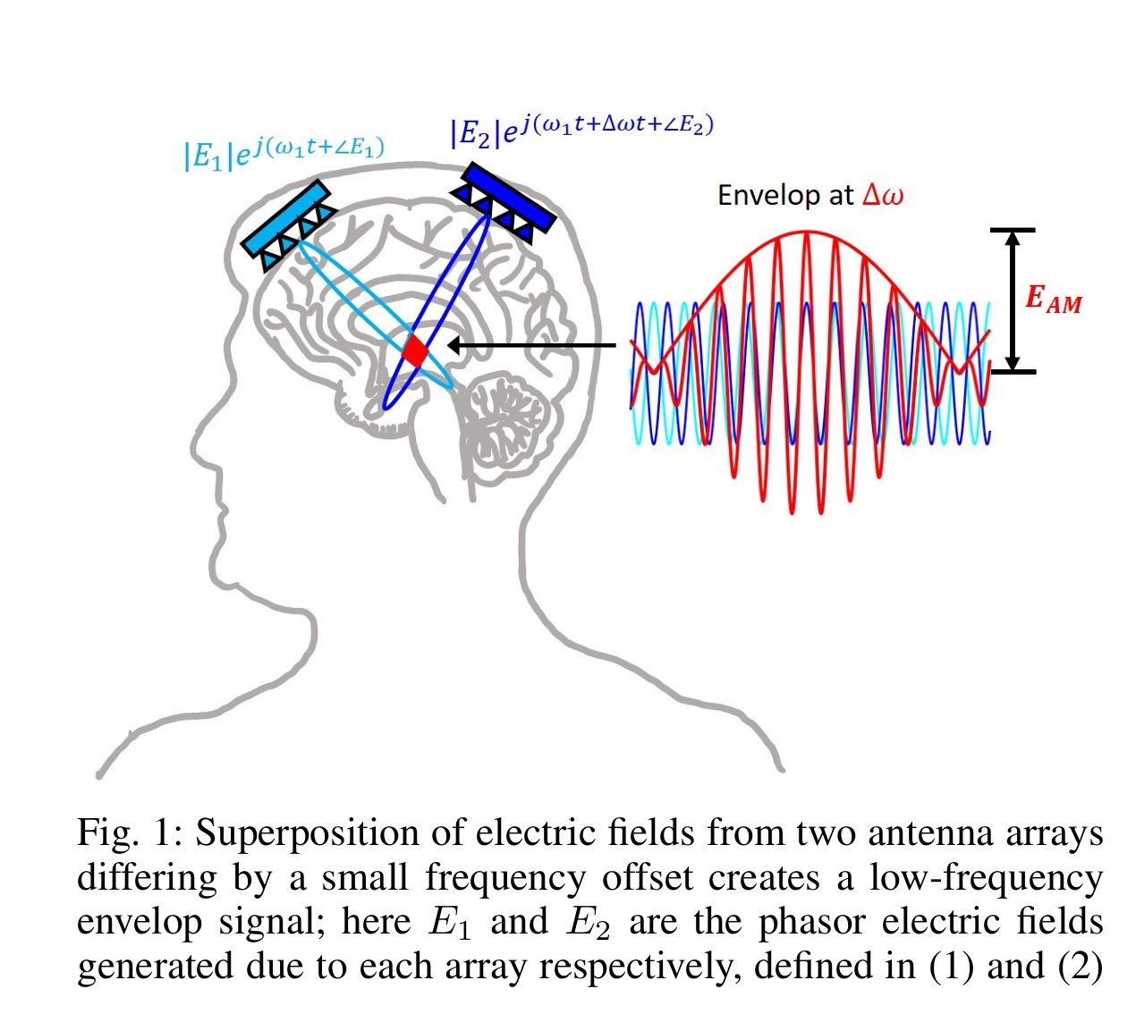

First, you need to make sure that you actually get the mathematics of what you want to do. In the attached picture it is seemingly a 'superposition of phasors that have two slightly different frequencies', and so that suggests a sum, in which case you can do what Robert says, and run each frequency on its own and then combine studies to get the full solution. But the attached picture also mentions E_AM, suggesting Amplitude Modulation, which in turn would imply a multiplication, in which case you need a time domain solution.
Try setting up two analytical solutions in COMSOL (no FEM), and compare sin(100[Hz]t)+sin(101[Hz]t) and sin(100[Hz]t)sin(1[Hz]*t)
and look at the frequency content of each of them. I sounds like you want to do the former of the two, but make sure.
