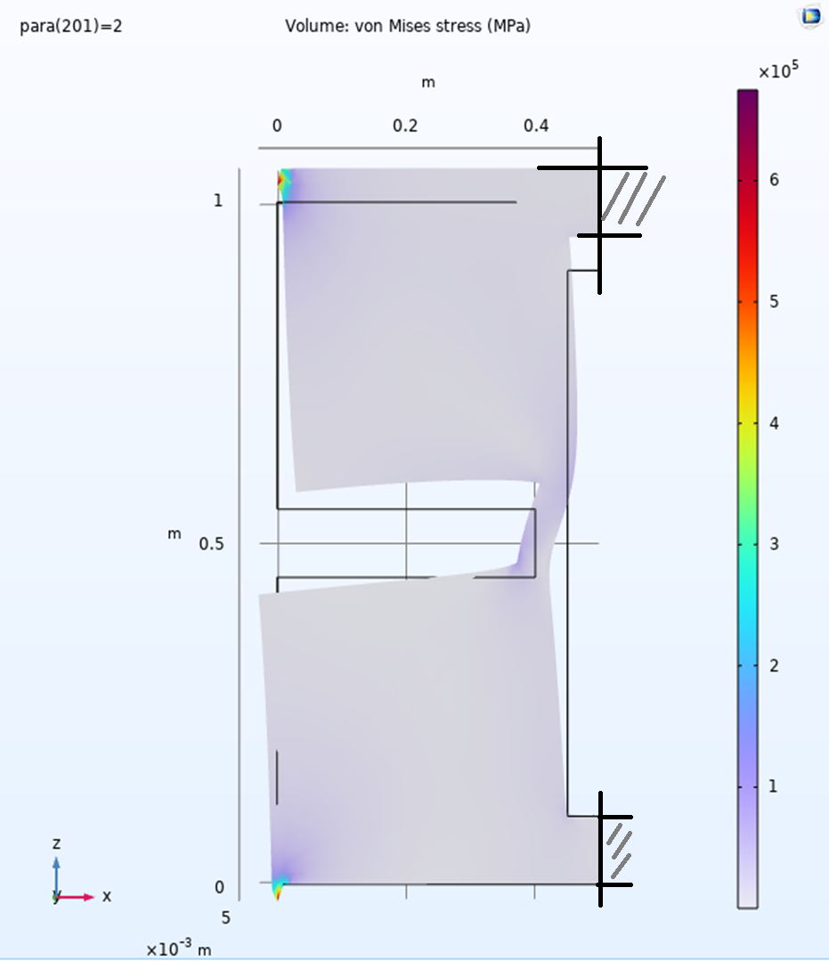

I am working with model having symmetric geometry. So, I want to utilize the symmetry node in simulation. However, when I receive the results, I think there is no symmetry in my model !
Please let's me know the reason and where I did wrong step.

You do have symmetry. The symmetry is at the two boundaries you have selected.

I have selected the symmetry for two boundaries, but the results show that these boundaries seem not to be symmetric. This is my feeling, is it correct ?
>You do have symmetry. The symmetry is at the two boundaries you have selected. I have selected the symmetry for two boundaries, but the results show that these boundaries seem not to be symmetric. This is my feeling, is it correct ?
Posted: 2 years ago 06.12.2024, 02:35 GMT-5
Don't you have symmetry right at those boundaries, as indicated in my png?

Posted: 2 years ago 09.12.2024, 03:19 GMT-5
I have symmetry in these boundaries.
Posted: 2 years ago 09.12.2024, 05:48 GMT-5
And that is all that this symmetry condition gives; symmetry at those specific boundaries.

Posted: 2 years ago 09.12.2024, 07:16 GMT-5
Thank you, now I understand.
>And that is all that this symmetry condition gives; symmetry at those specific boundaries. Thank you, now I understand.
Posted: 2 years ago 10.12.2024, 01:19 GMT-5
Great! Remember that physics and study matter when it comes to symmetry, such that acoustics is different than solid mechanics, when comparing the geometrical symmetry with the physics symmetry, and a driven response might require different thoughts about symmetry than an eigenmode analysis. COMSOL has blog post about this (https://www.comsol.com/support/learning-center/article/Using-Symmetry-to-Reduce-Model-Size-35921) and I have written about it too (https://audioxpress.com/article/simulation-techniques-dimensional-reduction-for-vibroacoustical-simulations)
