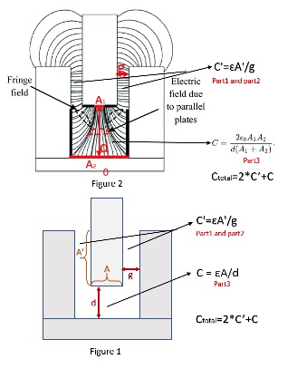

The capacitance I obtain for my structure using COMSOL is 38 femtofarads, but when I calculate the same structure in MATLAB, the capacitance increases to 54 femtofarads. I know that COMSOL takes fringing fields into account when calculating capacitance.

Dear Jeff, Thank you for your response and clarification. The structure of my sensor is based on variable area for capacitance calculation, while the gap remains fixed. In fact, I performed the MATLAB calculations using classical formulas for capacitance computation, considering the three parts (1, 2, and 3) as shown in Figure 1. Unfortunately, the difference between the capacitance values computed in MATLAB and COMSOL still exists. Using the classical formulas: • The capacitance calculated in MATLAB equals 54 femtofarads, while the capacitance obtained from COMSOL for a bias of 1g (acceleration) is 38 femtofarads. Next, as shown in Figure 2, I modified my MATLAB calculations by using the formula provided in Figure 2 specifically for part 3, while for parts 1 and 2, I continued using the formulas from Figure 1. With this adjustment: The capacitance computed in MATLAB equals 49 femtofarads, but the capacitance obtained in COMSOL remains 38 femtofarads for the same bias of 1 g. "As a side note, the formula used in Figure 2 (part 3) is specifically applied to calculate the capacitance of parallel plates with varying areas." In your opinion, is this formula applicable to our structure? Despite this refinement in the MATLAB calculations, the difference between the MATLAB and COMSOL results persists. Given this, I have the following questions: 1. Is the difference between the MATLAB and COMSOL results expected and within an acceptable range? 2. What would you suggest as a solution to align the MATLAB calculations with the COMSOL model so that fringing fields are accounted for more accurately? And please kindly let me know if you have any suggestions for reducing this difference or if additional steps are required to align the MATLAB calculations with the COMSOL results. Bests, Amir![https://drive.google.com/file/d/1Ui3r-XKwp8TRIi6ikueGQ0gZrzapw_Dn/view?usp=drive_link]

I was not able to access the files; I would recommend you post them directly into this thread. With that said, your post does suggest to me that your MATLAB methodology presumes some form of simplification that is not made in the COMSOL model, resulting in different results.

Thanks, Amir. So, yes, it is as I suspected: your MATLAB methodology is based on analytical expressions. With PDEs, analytical solutions are typically only available for very specific geometries (simple shapes, etc) and physical assumptions. Stretching their use to a case where those simplifications are not fully satisfied is certainly something that is commonly done in engineering, and it can frequently yield very useful information about a system. Unfortunately, it is hard to predict how far off the resulting values are going to be from the exact solution. When possible, solving the PDEs with a tool like COMSOL yields more accurate values due to fewer or less stringent simplifications being made. The ~20% difference between your two results (49fF vs 38fF) does not strike me as unusual.
