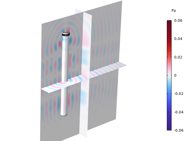

I attach model to clarify. I have tried to use segregated solver but still as suggest from Acculution ApS but still is too computationally expensive. I do not know how to set the boundary condition from the solid mechanics study and use them in pressure acoustic boundary element. I had a look at some tutorial but still is not working.
I noticed that the model is using a Fully Coupled, Direct Solver which is quite expensive for BEM in 3D. In the model attached here, I right clicked Solver Configurations->Reset Solver to Default. I then enabled the second suggestion for iterative solver (GMRES with Direct Precon.) as this showed better convergence after a test run.
The last change I made was under Pressure Acoustics, Boundary Elements->Quadrature to enable Thin gap handling. This is needed for accuracy for BEM when narrow regions exist in the model, such as the thin walled cylinder.
The first model attached here solved in ~20 minutes with about 20 GB RAM for me, which is not bad. The screenshot shows the acoustic pressure from the vibrating structure.
Out of curiosity, I also setup the model with a segregated solver. Step 1 solves for the structural DOFS, while Step 2 is the acoustics. In terms of run time, this was similar however the log reported about 15 GB RAM this time.
Hope this helps, -Mark
