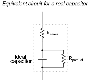

I am having trouble modeling something. I would like to look at the conduction/conductance/resistivity of a insulating/conductive composite. It could be thought to be like a polymer/insulating fiber system. Electrically, the polymer itself is referenced in literature to look like a capacitor and resistor in parallel. The capacitor illustrates the ideal dielectric capacitor that one might expect and the resistor illustrates the leakage that actually flows through the capacitor when placed in a potential. The illustration is on Tony Blythe's 2nd edition "Electrical Properties of Polymers" book on page 156. I've attached an image of the equivalent circuit I am talking about(not exactly the image from the book though).

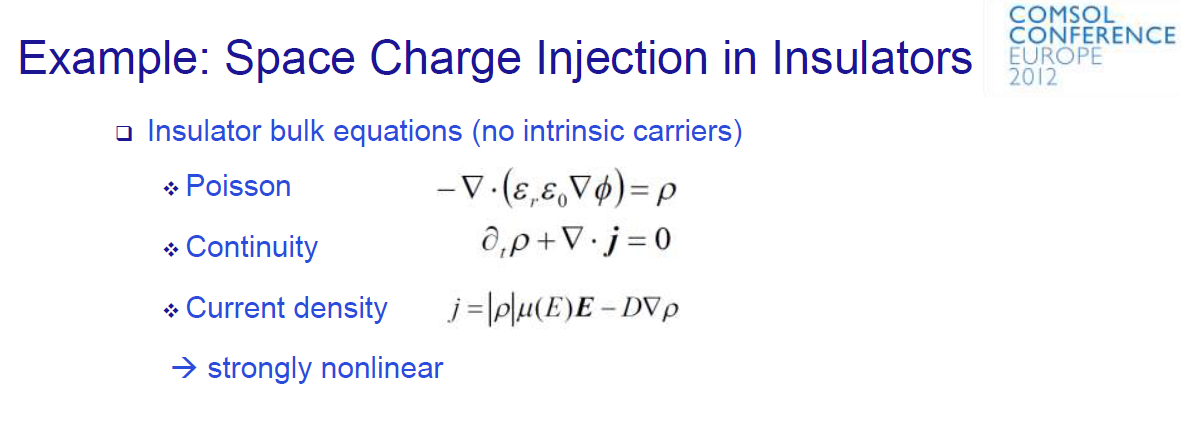

I noticed in a presentation by Christen on the Comsol Conference that uses the Poisson and Continuity Equation together. I've attached a screen shot of the slide. Is there any way I can attach an equation to the ES that will allow for a little bit of current to flow? Maybe this suggestion is completely off base, but I am just trying to figure this something.

I would say that in your model with the copper conductivity of 6e7 S/m and the nylon with 1e-1 S/m it IS just a little bit of current in the 'insulator'. You have 8 orders of magnitude in the model. You could try now to tweak the solver to increase the span.
Which specific question to the model remains unanswered? I don't think the publication you cited is applicable to your question.
