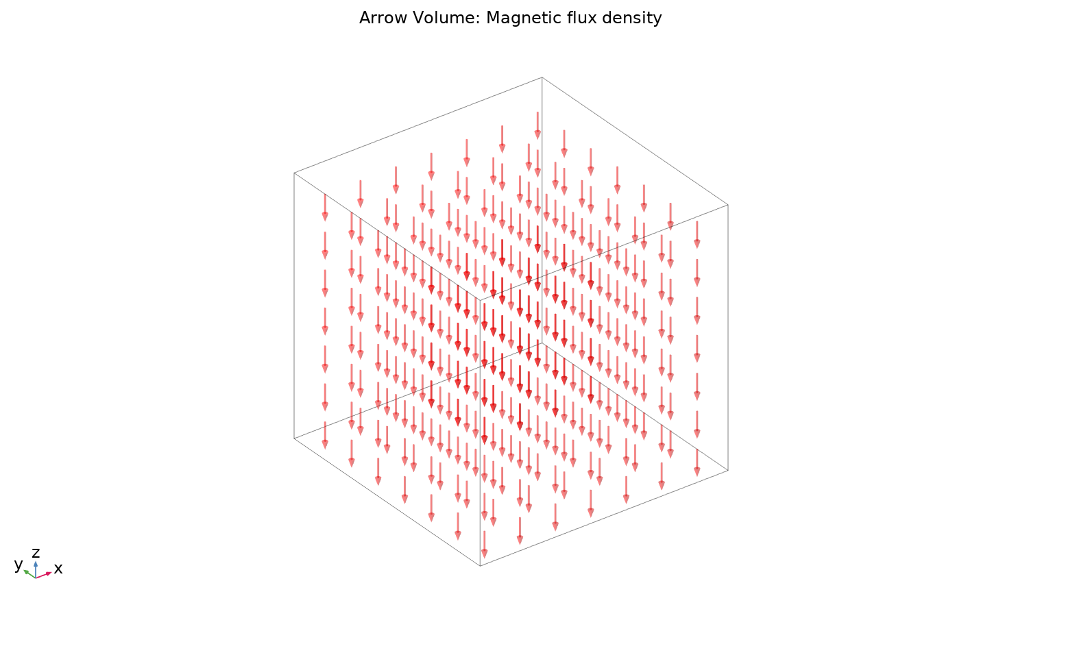

Hi all, I'm trying to model a magneto-mechanical interaction (my focus is on the structure) and I need to apply a uniform magnetic flux density in a cube of air (which is my domain) in the z direction. Is there a way to do it? I've tried different things (magnetic potential, magnetic field and others) but they don't work. Thank you for your help

A simple approach using magnetic potentials worked for me. Much like a simple capacitor in electrostatics. See attached. I'm assuming you have version 6.3.
