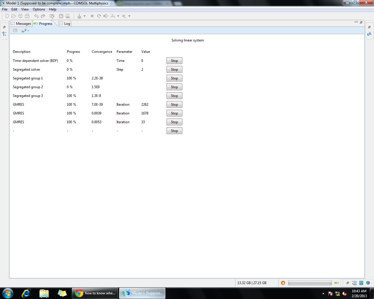

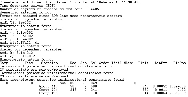

I was running my HT+NITF model for simulation for 2 days. But, still I was not able to obtain the convergence. The progress of my simulation after 2 days of running is as follows (in the picture "Untitled.jpg).. Please let me know how to attain convergence... I am unable to make changes as I was being suggested each correction at each point of problem which is not working out perfectly. The log information at this stage is as follows... (Log data at 4.02 PM 19th feb.jpg).
Please help me out in getting a solution.

why are you running HT + NITF, NITF is already solving for T and the others, so you are solving twice for T and J, and these are then probably NOT correctly linked in you model.
Always check the dependent variables and the equations for all complex physics to avoid adding in two that solves for the same varaibles
Hi why are you running HT + NITF, NITF is already solving for T and the others, so you are solving twice for T and J, and these are then probably NOT correctly linked in you model. Always check the dependent variables and the equations for all complex physics to avoid adding in two that solves for the same varaibles -- Good luck Ivar
