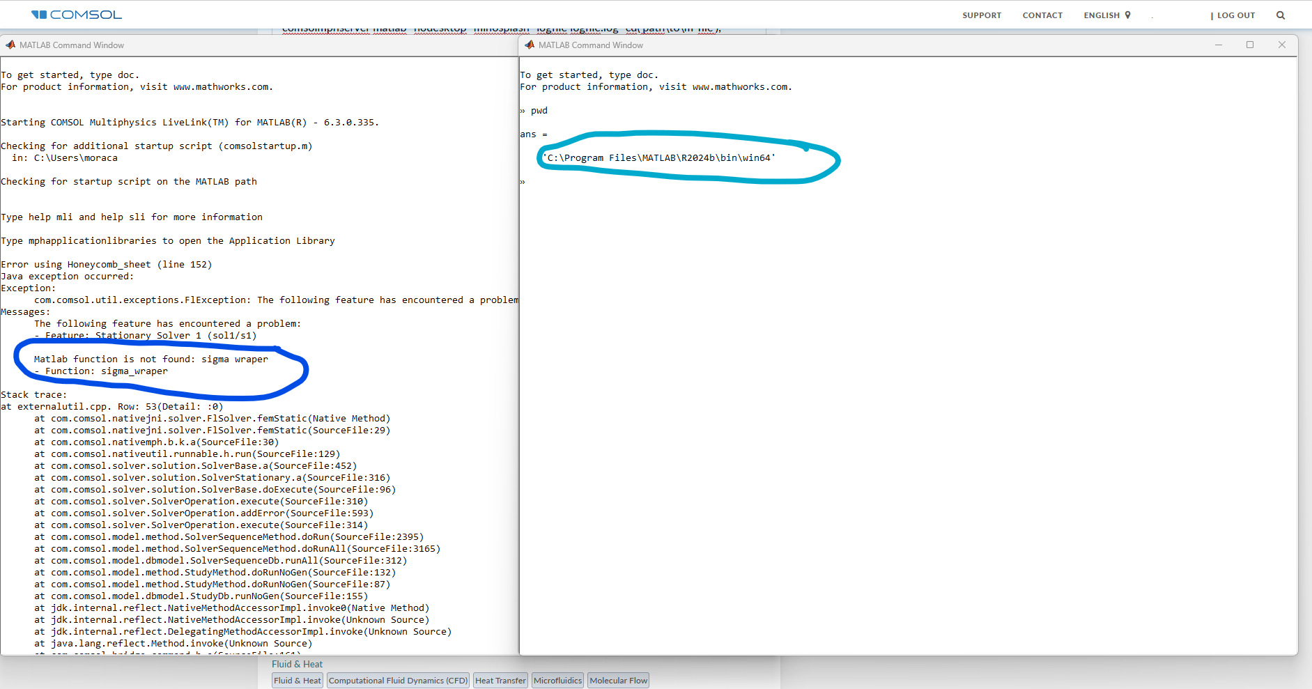

I have the file there. I think the issue is that there are two emerging windows as shown in the attached screenshot. By using pwd I noticed that one of the windows has the correct simulation directory but the other widow has the Matlab root directory as the working directory. So because of that, I think it is looking for my sigma_wraper.m in Matlab's root directory.

You have three options: 1) Add the directory where your M-files are placed to the Matlab path and save the path
2) Save your model as an MPH-file in the same directory as the Matlab files before setting uf the function call
3) Add the environmental string COMSOL_MATLAB_PATH to your computer's settings with the value of the directory of your Matlab files. You probably need to restart your terminal window after having made this change
