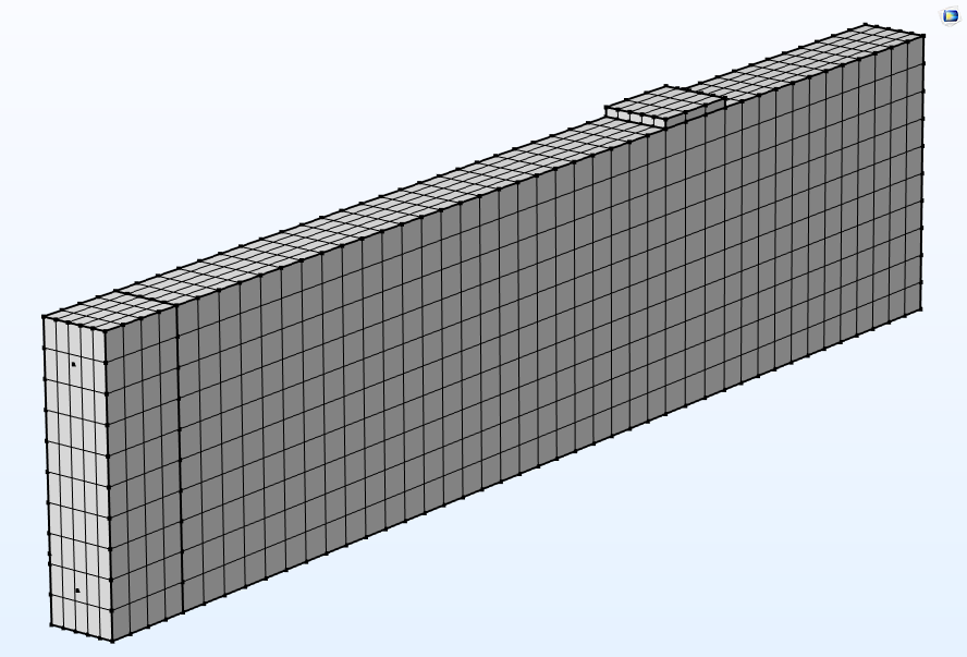

Question 2 The Coupled damage-plasticity model includes more aspects of the mechanical properties of concrete compared to the Ottosen model, for example softening in tension. Inevitably this means that the model introduce more nonlinearities and is thus more sensitive to an under resolved mesh and mesh elements with poor quality. When a model includes damage it is also recommended to use a linear discretization for the displacement field.
My suggestion is to :
  • Improve the mesh, see attached image for the mesh I used.
  • Use a linear displacement field
  • Specify the tension softening part of the model using fracture energy or a displacement limit to reduce mesh bias.
  • Allow a smaller minimum step size by modifying the continuation settings of the Parametric node in the solver sequence.
With these changes I can solve study 2 and get a ultimate load of approximately 225 kN compared to 260 kN from study 1.

How did you mesh this mesh with the tendons? Also there is no symmetry with these tendons!.
