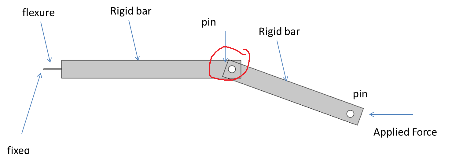

Hi all,
I am trying to simulate a compliant mechanism as seen in the attached picture but I am having difficulties simulating the rotating pin in 2D. As see in the picture the structure is composed of a flexing member and two rigid members connected by a pin. I made the geometry into an assembly instead of a union, the rotating pins as rigid connectors and the rigid bars as rigid domains. My question is how to model this rotating pin, I saw an example in 3D but I am not sure how to do this in 2D. Let me know what you guys think, I appreciate your help.

COMSOL is not the easiest to do rigid body physics, I would suggest to use a 2D shell for the flexure and a 2D bar for the two "rigid bars", from their relative size you can make them "infinite" rigid compared to the flexure. In this way you have only 3 lines to draw, and you can add "hinges easily, for the shell elements do not forget to couple the displacement AND the rotation

If you wish to do things using rigid connectors, you should simply set the two translational degrees of freedom equal; e.g u_rig1 = u_rig2 and v_rig1 = v_rig2. Both rigid connectors should have their center of rotation at the pin center.
But since the outer part is free to rotate around the pin, the model is a mechanism. The way you have sketched it, it could only be used in a transient analysis, since it has one possible rigid body rotation.
With reference to Ivar's answer above: There is nothing such as a 2D shell, so I assume that he means 2D beam. The 2D beam has no geometrically nonlinear formulation, so in that case the rotation of the inner part must be small.

Thank you for your responses. I was able to model the mechanism successfully in 3D for low applied loads.
Now I am running into convergence issues when I input a pre-described displacement on the moving rigid connector.
Since I am expecting large deformations, I checked the geometric nonlinearity option and I am using a parametric solver through the study extension option to help the solution converge, however, I have been unsuccessful.
Do you know of any tweaks with regards to the solver settings that may help convergence for a geometric nonlinear problem? i have been following the "large deformation beam" example and I changed the relative tolerance to 1e-6 but still no go. For now, I am going to make my mesh finer in the areas of interest and see what happens.

I got it to converge, one of the global constraint equations for the rigid connector was wrong.
