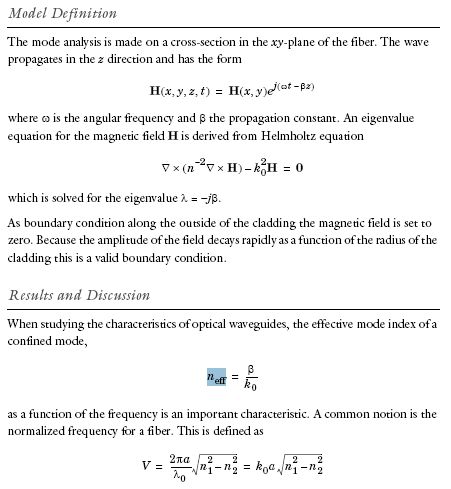

For me, the complex value you see is not "n" nor "neff", but "beta" from the definition eigenvalue:
lambda = i*beta
and
neff = beta/k0
with k0 being the k0=2*pi/lambda0
these are also linked to the normalized frequency of the fibre "V" for a fibre core radius "a" (see attached jpg)
so you must do some maths to get "neff" (that is done inside Comsol for "neff_rfwf" have a look at the "Model tree - scalar variables" and for other the internals definition in "physics - equations systems - subdomain equations - variables" (unfortunately these cannot be easily sorted by names !!)^
Hope this helps
