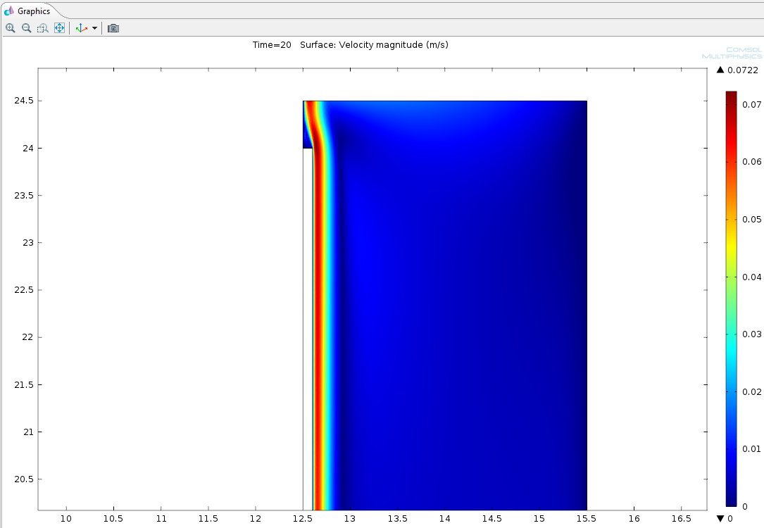

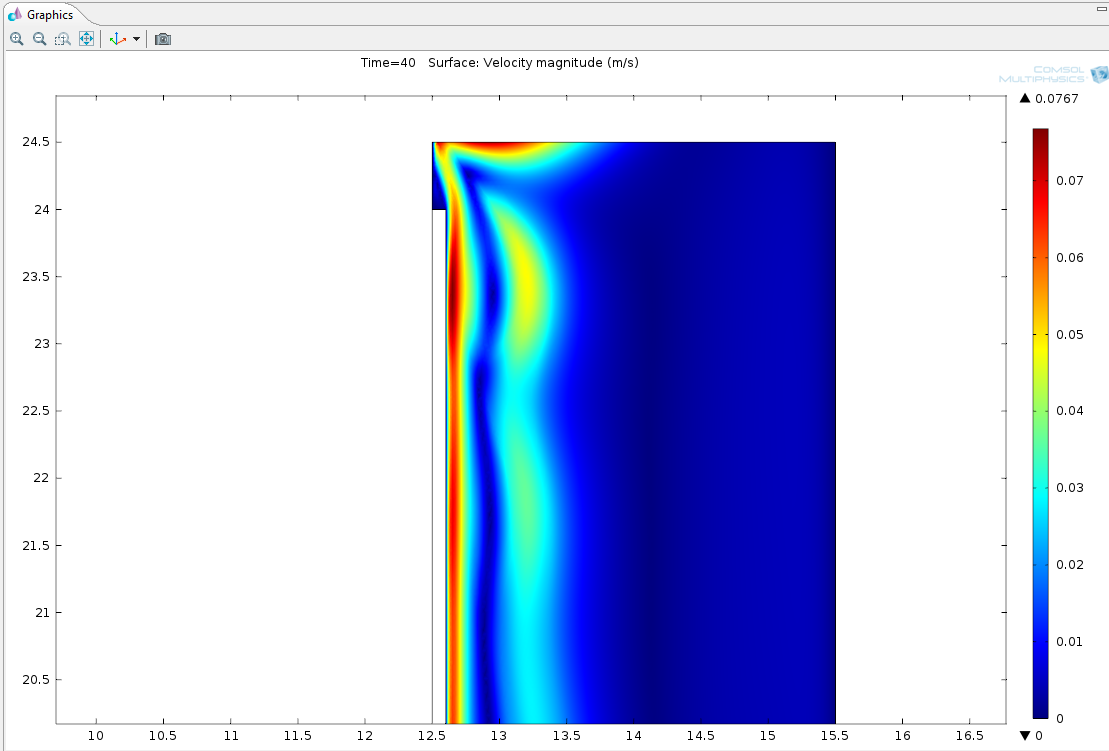

I am wondering how I can improve convergence in my natural convection model. It is a simple model; an isothermal aluminum plate in water.
The model starts out fine but as the run continues (transient model), the plume begins to lose stability causing the problem to reduce its time stepping. I have tried re-meshing as much as my PC can handle (3 mil elements).
I am wondering what else I can do to solve this problem. Should I change tolerances, crosswind or streamline parameters. I am running out of ideas. Any help would be greatly appreciated ( as I have been stuck on this problem for several days now). I have attached the model (with no mesh or solution). Typically, the model solves the first 20-30 seconds, then the solution becomes very strange and results become unreasonable.

Edited: I added some of the solutions so readers do not have to open and run the model. Solutions are plotted for times 20, 30 and 40 seconds into the simulation.
I additionally tried using segregated solvers (2 segregated solvers 1 for pressure and velocity and 1 for temperature). I have read this should help solve highly nonlinear problems. But again after about 30 seconds into the transient solutions, the solution fails. Edited: I added some of the solutions so readers do not have to open and run the model. Solutions are plotted for times 20, 30 and 40 seconds into the simulation.

Posted: 1 decade ago 26.04.2013, 07:50 MESZ
first of all I'll advise you to check if you cannot upload the latest patch to v4.3a, you do not have the latest version I see
then I would propose that you fillet off all your corners with small radii, your sharp edges makes singularities
Further I'm not sure why you solve first for time and then a stationary, as for t=0 you do already solve the equivalent of a stationary case
T follow what is going on, I recommend to turn ON the plot while solving FORA all solver steps, you will then notice that your fluid is rapidly getting turbulent and that your solver has issues to find steady solutions
Finally I would also recommend that you rebuild your model from scratch, you have disabled a few nodfes, bu I notice that I cannot even delete these, so it's as if your internal pointers in the file have become corrupted. This happens sometimes, when you modify heavily a model, adding and removing nodes and solvers over longer periodes
Hi first of all I'll advise you to check if you cannot upload the latest patch to v4.3a, you do not have the latest version I see then I would propose that you fillet off all your corners with small radii, your sharp edges makes singularities Further I'm not sure why you solve first for time and then a stationary, as for t=0 you do already solve the equivalent of a stationary case T follow what is going on, I recommend to turn ON the plot while solving FORA all solver steps, you will then notice that your fluid is rapidly getting turbulent and that your solver has issues to find steady solutions Finally I would also recommend that you rebuild your model from scratch, you have disabled a few nodfes, bu I notice that I cannot even delete these, so it's as if your internal pointers in the file have become corrupted. This happens sometimes, when you modify heavily a model, adding and removing nodes and solvers over longer periodes -- Good luck Ivar
