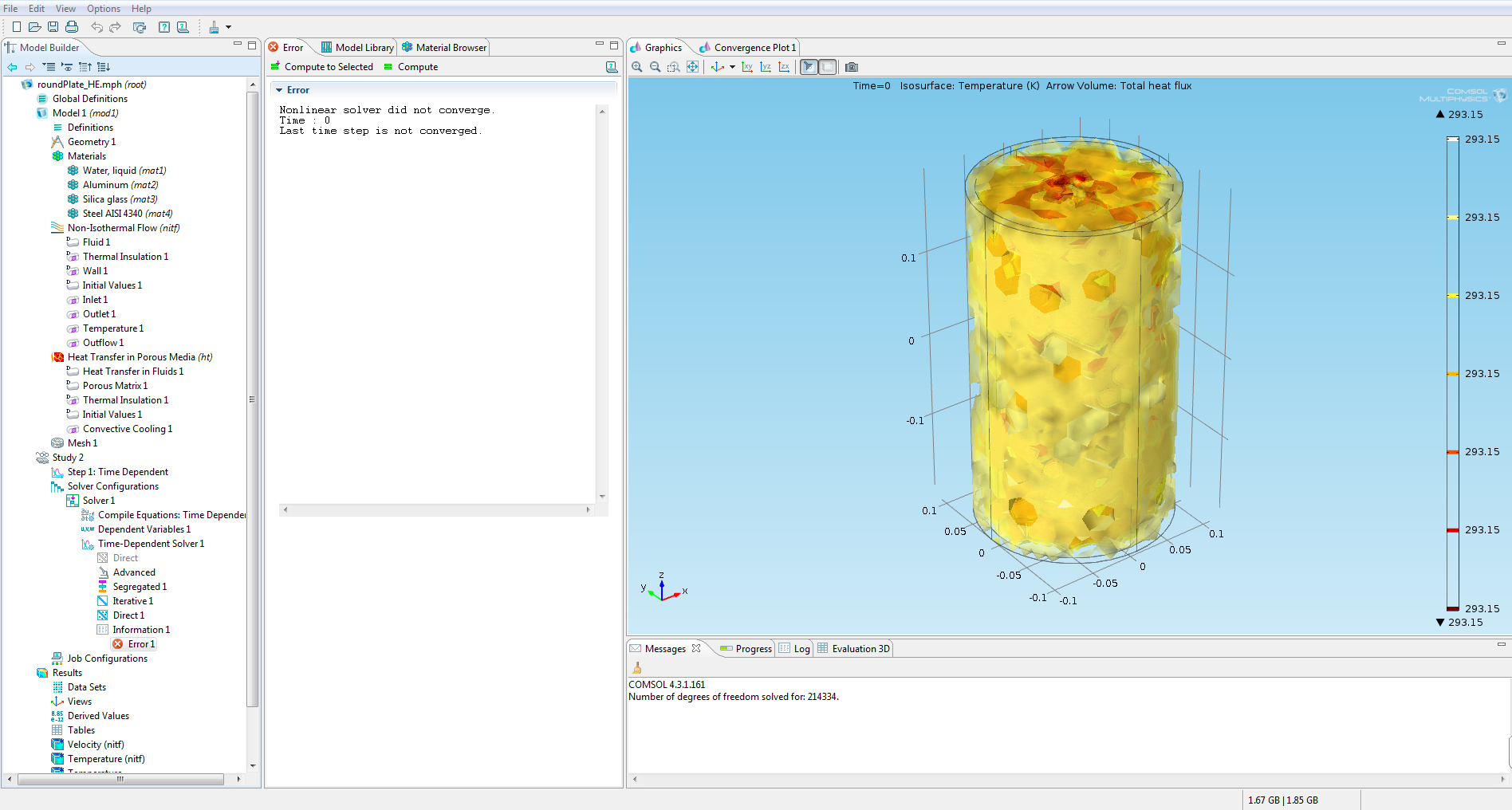

Posted: 1 decade ago 07.03.2013, 16:26 MEZ
Hi Ivar,
In attached is a picture file of my model. It's too heavy for uploading.
Now I've adjust some parameters and I could see the solid temperature distribution, but with no variation. And there is an error: Solution did not converge! What can I do here? I've checked all the used parameters, adjust and run but still obtained same wrong results.
A. Fopah Lele
Dipl.-Phys. & Msc.
Hi Ivar, In attached is a picture file of my model. It's too heavy for uploading. Now I've adjust some parameters and I could see the solid temperature distribution, but with no variation. And there is an error: Solution did not converge! What can I do here? I've checked all the used parameters, adjust and run but still obtained same wrong results. Regards, -- A. Fopah Lele Dipl.-Phys. & Msc.
Posted: 1 decade ago 07.03.2013, 23:21 MEZ
one thing for uploading, clea the solutions and the mesh (Edit clear all solutions ...) and File reset history, then save (with a new name) and upload the almost "empty" model file, then it will fit ;)
Also, if the model is big, try to start with a much simpler one, set up the model, palay with it until it gives reasonable results (simple model = one you can really and easily guess the results) then build up your more complex model
Hi one thing for uploading, clea the solutions and the mesh (Edit clear all solutions ...) and File reset history, then save (with a new name) and upload the almost "empty" model file, then it will fit ;) Also, if the model is big, try to start with a much simpler one, set up the model, palay with it until it gives reasonable results (simple model = one you can really and easily guess the results) then build up your more complex model -- Good luck Ivar
