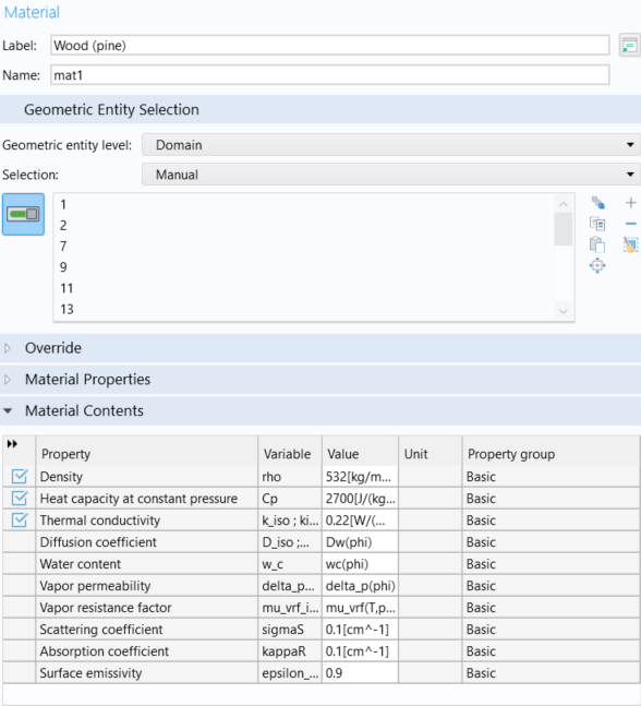

  1. When I choose for emissivity by material in 'Diffuse Surface 1', it gives the error of not having epsilon_rad with the material. This I added to the material.

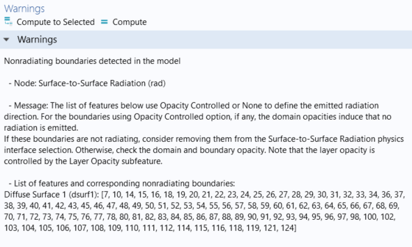

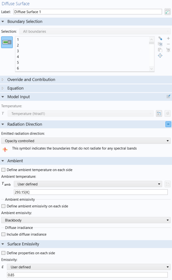

  2. When I choose for emissivity by User defined, and fill in 0.85, it gives the error of missing variable 'comp1.rad.dsurf1.Ju_band'. Which I need to add to an existing step or new one.
Is it possible to simulate this and have both heat transfer and surface to surface radiation?
