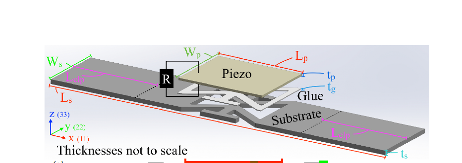

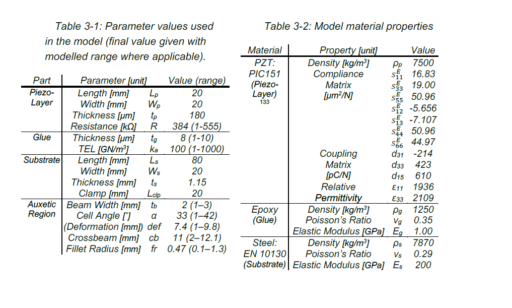

Correct approach to model epoxy bonding using thin elastic layer? Do we need to model epoxy or not and define TEL between substrate and epoxy & PZT and epoxy? How to determine value of Ka?
