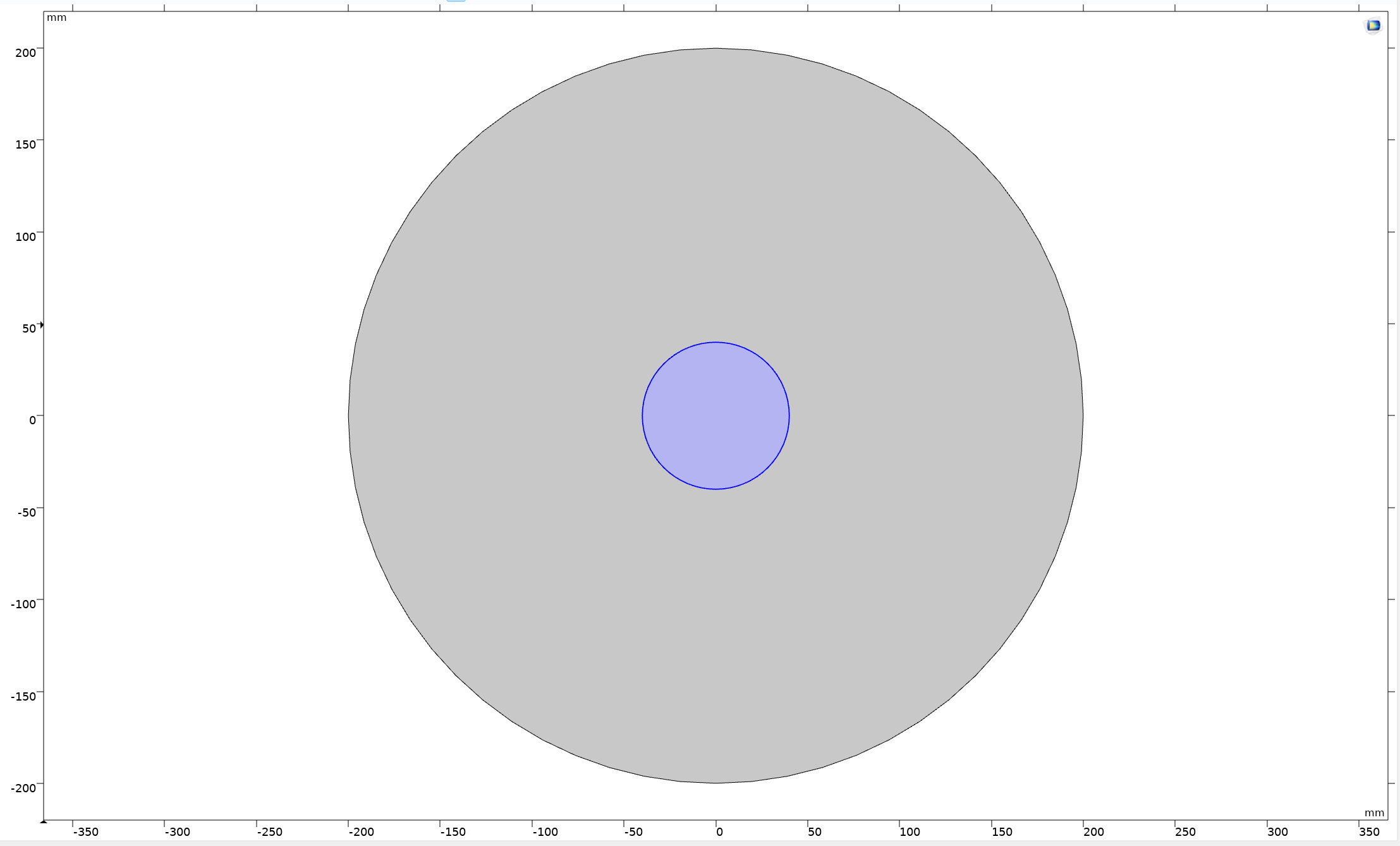

I’m trying to calculate the area moment of inertia (Ixx and Iyy) for an arbitrary 2D shape. As a simple example, consider a cross-section composed of two circles—I'd like to determine the area moment of inertia for this small circle.
Since the geometry can be arbitrary in other cases, I’m looking for a general method to compute Ixx and Iyy. I’ve noticed that COMSOL (e.g., through the "mass properties" function) provide mass-related properties like mass moment of inertia, but what I need are the area moments of inertia.
If anyone has suggestions or knows how to extract these values, I’d really appreciate your help.

those are integrals across the respective surface. Check the integration options in the Nonlocal Couplings.

Hi, those are integrals across the respective surface. Check the integration options in the Nonlocal Couplings. Cheers Edgar
