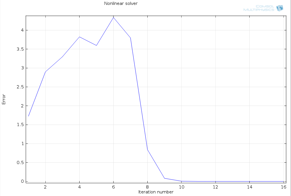

Dear Tom,
The point is that you don't know the exact solution. But you can estimate the (relative) error of your numerical solution, which is always an approximation. For example you can plug the numerical values back into the equations and see how well it matches. If it matches within an acceptable range (relative tolerance, e.g. 0.1% error) your numerical solution has satisfied the numerical convergence criterion.
Please find attached a convergence plot of a nonlinear model computation (created automatically in COMSOL). One image uses log-axis for the relative error, while the other uses a linear axis scale. Here the convergence criterion is set to 1e-6 (=0.0001% relative error / tolerance) and it took 16 iterations to reach convergence.
Another important topic is "mesh convergence". Your solution is mesh convergent if a global/local mesh refinement doesn't significantly change the results. For efficient modeling your goal is to create a mesh that just fulfills mesh convergence but is not finer than necessary in order to keep computational expense as low as possible.
I hope this gives you a clearer picture.
Zoran

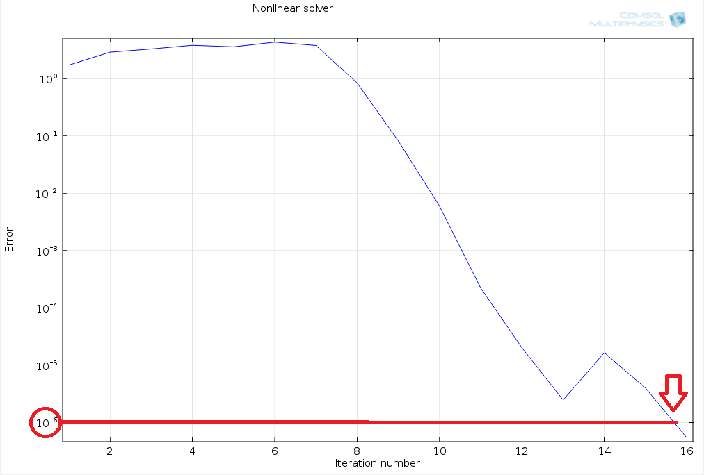

Posted: 1 decade ago 30.03.2013, 02:05 MEZ
I found the convergence plot shows the linear-axis.
How can I change the setting from the linear-axis to log-axis?
Best wishes,
Ken
I found the convergence plot shows the linear-axis. How can I change the setting from the linear-axis to log-axis? Best wishes, Ken

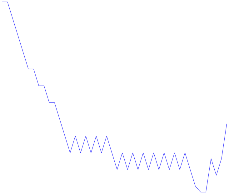

Posted: 9 years ago 02.05.2016, 11:41 MESZ
Hi Zoran,
I am working with COMSOL 5.2. The issue I am facing is that my convergence plot is a semi-log plot showing reciprocal of time-step v/s time step, even though I have fixed the time step. I am not able to infer from this graph whether my solution has converged or not. I am attaching a picture of the same. Please suggest a solution.
Thanks,
Mahvash
Hi Zoran, I am working with COMSOL 5.2. The issue I am facing is that my convergence plot is a semi-log plot showing reciprocal of time-step v/s time step, even though I have fixed the time step. I am not able to infer from this graph whether my solution has converged or not. I am attaching a picture of the same. Please suggest a solution. Thanks, Mahvash

Posted: 9 years ago 02.05.2016, 14:52 MESZ
Mahvash-
It doesn't quite look like your time step is fixed if it is jumping up and down. Perhaps you've fixed the time range output request steps?
Secondly, you can always check your error estimate(s) by looking at the log window.

Posted: 9 years ago 02.05.2016, 16:49 MESZ
Hi Josh,
Thanks for your response. I haven't been able to figure out why my graph is oscillating . However, I did check the log and it shows
Linear error = 1.8*10^-13
Linear residual= 1.5*10^-15
Tfail=0
NLfail=21
Can you please tell me what is the significance of NLfail. In the reference manual it says that it is the failures in non-linear iterations.
Also, even though my problem involves non-linear equations also, why does my log show data pertaining to time dependent linear solver?

Hi Josh, Thanks for your response. I haven't been able to figure out why my graph is oscillating . However, I did check the log and it shows Linear error = 1.8*10^-13 Linear residual= 1.5*10^-15 Tfail=0 NLfail=21 Can you please tell me what is the significance of NLfail. In the reference manual it says that it is the failures in non-linear iterations. Also, even though my problem involves non-linear equations also, why does my log show data pertaining to time dependent linear solver? Thanks once again Mahvash
Josh Thomas Certified Consultant
Posted: 9 years ago 02.05.2016, 16:58 MESZ
Mahvash-
Unless you are manually overriding the default time dependent solver, the time steps will oscillate over the course of a time dependent solution. This is because the step is selected by the solver in order to take the largest step possible but still satisfy the absolute and relative error tolerances that are pre-specified. There is also some manual limit on the step size you can provide by selecting Time stepping method: Strict or intermediate (instead of Free which is the default).
All finite element problems will solve a linear (or linearized) system of equations at the deepest level -- even if non-linear Newton iterations need to be performed because of the non-linearity of the problem.
NLfail means that the non-linear iterations (typically Newton iterations) are failing to converge.
Josh Thomas
AltaSim Technologies
Mahvash- Unless you are manually overriding the default time dependent solver, the time steps will oscillate over the course of a time dependent solution. This is because the step is selected by the solver in order to take the largest step possible but still satisfy the absolute and relative error tolerances that are pre-specified. There is also some manual limit on the step size you can provide by selecting Time stepping method: Strict or intermediate (instead of Free which is the default). All finite element problems will solve a linear (or linearized) system of equations at the deepest level -- even if non-linear Newton iterations need to be performed because of the non-linearity of the problem. NLfail means that the non-linear iterations (typically Newton iterations) are failing to converge. -- Best regards, Josh Thomas AltaSim Technologies
Posted: 9 years ago 02.05.2016, 18:29 MESZ
Josh,
In that case, how can I tell from the convergence plot whether or not my solution is converging? Please correct me if I am wrong, is it that a smaller reciprocal of step size with increasing time step would imply convergence, as the solver does not need small steps for the solution to converge?
Also NLfail=21, is that a very bad figure. I don't know how to interpret it with regards to convergence.
Thanks,
Mahvash
Josh, In that case, how can I tell from the convergence plot whether or not my solution is converging? Please correct me if I am wrong, is it that a smaller reciprocal of step size with increasing time step would imply convergence, as the solver does not need small steps for the solution to converge? Also NLfail=21, is that a very bad figure. I don't know how to interpret it with regards to convergence. Thanks, Mahvash
Posted: 9 years ago 03.05.2016, 14:59 MESZ
You are understanding things correctly. As the reciprocal of the time steps goes down the solver is moving faster towards the finish line.
A problem can fail to converge in the time domain or in the spatial domain. TFail implies temporal failure and NLFail means spatial failure. In either case, COMSOL will attempt to cutback the time step to achieve convergence. If the time steps become too small things will become painfully slow or eventually an error will be returned. Obviously, you'd prefer 0 (zero) failures in the solver, but sometimes non-linear systems of equations (especially multi-physics ones) are inherently highly non-linear.
There are a plethora of techniques for addressing non-convergence and speeding up run times, etc. Check documentation on solver settings, blog posts on addressing non-convergence, or consider signing up for training regarding solver settings in COMSOL.
